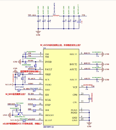

Hi team
Could you please help review the schematic?

Thanks for your question. Overall, the schematic looks okay. I am unable to verify the components values because of poor resolution and unable to zoom to read those. If you could share higher resolution image it'd be better. Be sure to have the thermal pad also connected to system GND.
