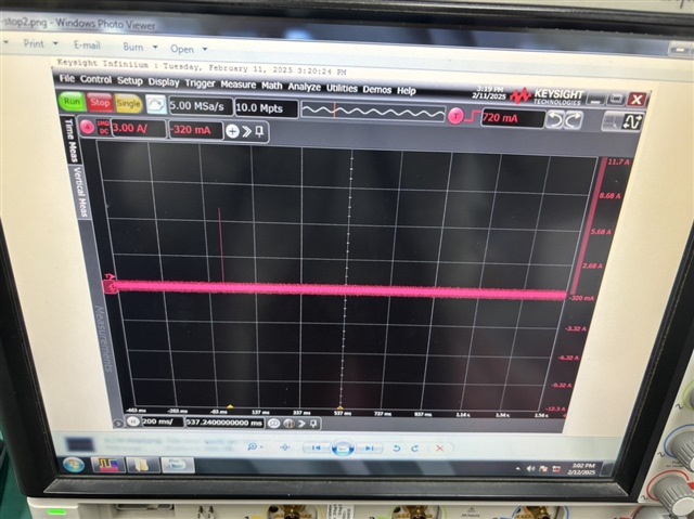

    Based on mct8136-q1 chip, we have obtained some new information during the recent test, and we hereby add that we hope you can help us to see if there are still relevant ideas for debugging
    The following are IPD alignments
    When the motor starts normally, the phase current waveform is all normal (basically consistent with the data manual)
    When the motor stops abnormally and is stuck in the MOTOR_IPD state, there is only one spike to the current waveform in the corresponding IPD alignment stage, and the motor cannot run. The nFAULT pin status is normal and no error is reported
    When the motor is at room temperature, the probability of the occurrence of the anomaly is less than one in 1000; When the motor is in an environment of -20 ° C, the anomaly will certainly appear within 100 times;
    I would like to know how the ambient temperature affects the motor, which in turn causes the drive chip to get stuck in the MOTOR_IPD state

    The above waveform is the phase current waveform of one phase when the motor falls into the abnormal state (stuck in the MOTOR_IPD state).
  • Thanks a lot for the waveforms. I see that you are using STM microcontroller for communication. Is it possible for the customer to use the MSP on our EVM to do I2C transactions? Why I am asking this is we have a few debug registers which are accessible only through the GUI. We want to write a few values to the debug registers which might fix this issue. Please let me know if this is possible.
