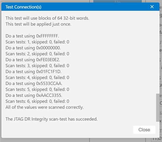

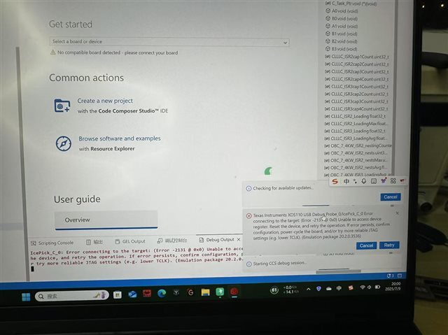

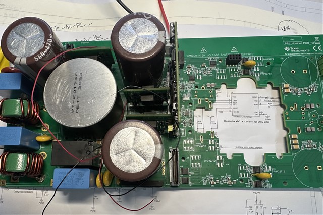

My team and I are replicating this circuit board.
When I was not connected to an auxiliary power source (12v 2A), JTAG is normal.
But when I connected the auxiliary power supply,JTAG will cease.
Could you please tell me the solution?

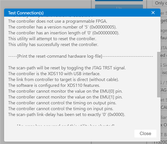

  • Before the auxiliary power supply was connected (12v2a), JTAG is normal.
    I replicated the circuit board exactly according to the schematic diagram.
    After connecting the auxiliary power supply(12v2A), JTAG has cease.
    The following errors occurred:(Error -2131 @ 0x0)
    Unable to access device register. Reset the device, and retry the operation. If error persists, confirm configuration, power-cycle the board, and/or try more reliable JTAG settings (e.g. lower TCLK).
    (Emulation package 20.2.0.3536).
    Could you please inform me as soon as possible of the reason? Is it due to a power supply issue?

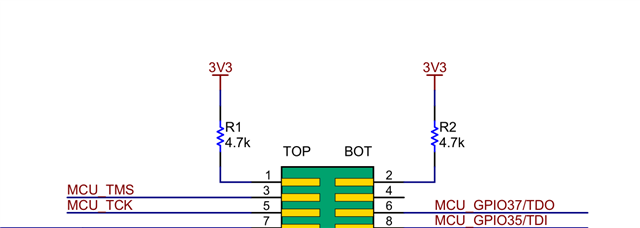

  • Hello,
    Can you try removing the F28003x controlCard from the PMP22650 dock and try to connect. If it works, then its likely a contention issue.
    The PMP22650 HSEC connector has connections to the JTAG signals. It also has an isolator on those signals. With regards to the controlCard, I believe the isolator is overpowering the JTAG signals being driven by the debugger.

  • Hello,
    There is a resolution requiring modification to the controlCARD board:
    1. C7:A should be removed
    2. Four traces in the front and back, highlighted in red below, need to be cut. There are no important traces in the layers below, please ensure that the trace is no longer connected or the controlCARD may not connect when inserted into the PMP22650.
    Cut two traces in the front:
    Cut two traces in the back:
    There are additional changes (adding caps to help with signal integrity), but that wont be the source of this contention issue.

  • Hi
    Is it about disconnecting these four pins from the pmp22650?
    The format of the picture you sent might be incorrect. I'm actually unable to view it. Could you specify which pin you are referring to?
  • Could you please help me identify exactly which four pins they are? The picture doesn't show clearly.
    Could you please answer my question? I'm very anxious.
    Thank you.
  • Hello,
    Yes, Pins 3, 5, 6, and 8 (corresponding to TMS, TCK, TDO, and TDI) need to be disconnected to eliminate contention.

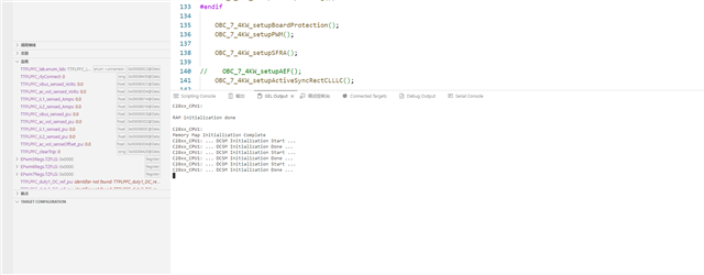

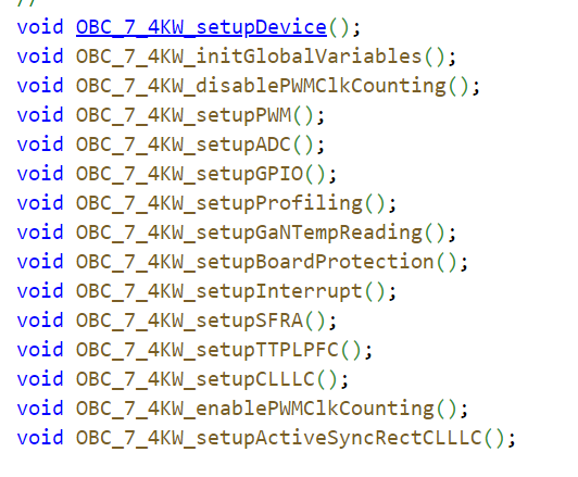

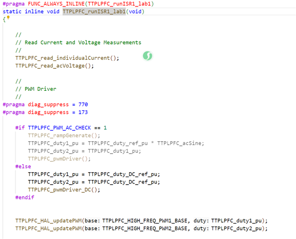

  • Hello, I have defined lab 1. However, during the power-on process, the ADC sampling was normal, but no 0.5 duty cycle was generated. Therefore, the output was the same as the input. Could you please tell me how to configure it?

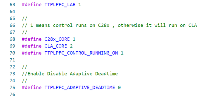

  • As shown in the figure, the lab1 ISR has been activated. Once the counter reaches 100, the relay closes and 120V DC is connected. However, there is no voltage boost, and the output is also 120V,
    In these function definitions, I have commented out any definitions related to CLLC and enabled all functions of the PFC.
    However, there is no PWM output.
    Could you tell me how to configure it?
    thank you.

    I am currently conducting lab 1. After debugging, the ADC is functioning normally, but there is no 0.5 pu output. The input is then sent out through this rectifier bridge. Could you please offer me some suggestions?
  • Did you check the above. May I know your observation please?
