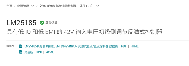

  • LM25185 is also an flyback controller which need external MOSFET. I have also attached the schematic design as the reference.
