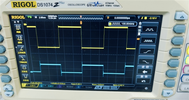

    I have tested two operating modes of this chip: IIM mode and PWM mode. In IIM mode, my input consists of two complementary 100kHz square waves. In PWM mode, my inputs are an enable signal and a 100kHz square wave.

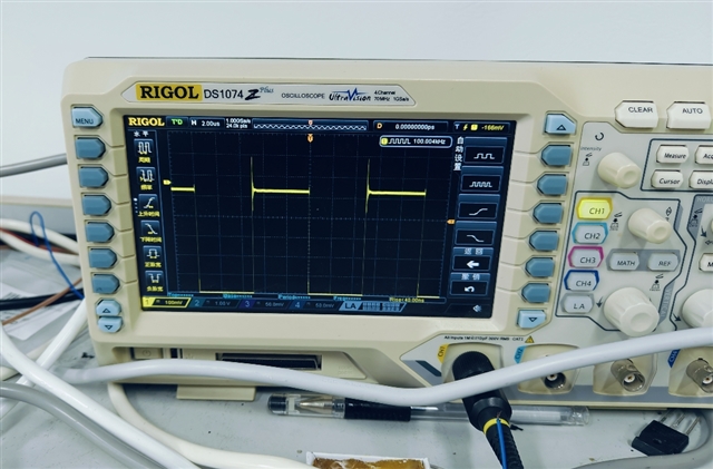

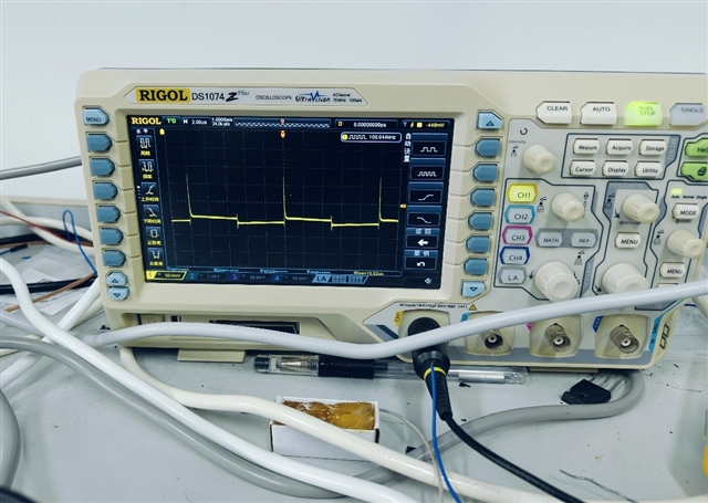

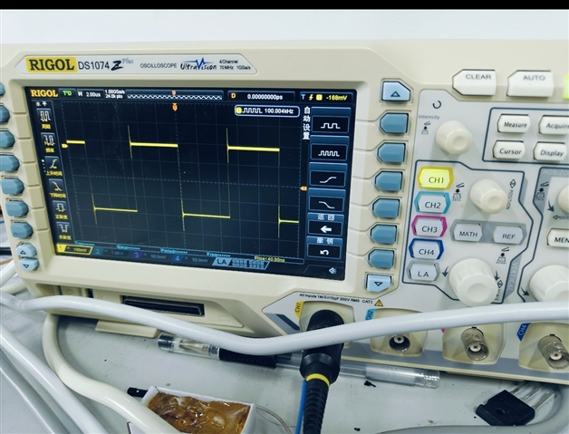

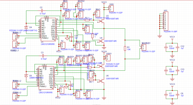

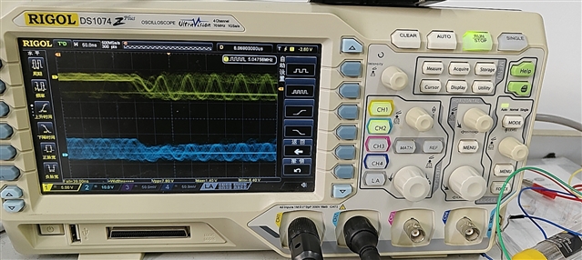

    The waveforms measured at the HO and LO output ports are shown in the attached figures. The waveform at the low-side (LO) meets expectations, but the high-side HO port and HS port show identical waveforms. While the output frequency is correct, the amplitude is not as expected.
    Could you please help explain why there might be an issue with the output waveform amplitudes of the HO and HS ports? I have attached my circuit schematic and the input/output waveform diagrams below for reference.The first diagram is my circuit schematic, the second one shows the input square waves, the third displays the output waveforms of the HS and HO ports, and the fourth presents the output waveform of the LO port. Thank you for your reply.

  • Thank you for your reply. First, I made an error in the test this morning, so I re-conducted the test. I found that there is no waveform between HO and HS. The HO-HS waveform I expected is a square wave with the same frequency as the input waveform and a voltage within the range specified in the datasheet.
    Second, I also saw no waveform across HB and HS (i.e., across the capacitor). Besides, the forward voltage drop of the transistor does not match the estimation in the chip datasheet. Therefore, I currently believe the issue lies in the bootstrap circuit. However, the selection and specifications of both the capacitor and the transistor meet the requirements in the chip datasheet, so I now suspect the problem is caused by the load.

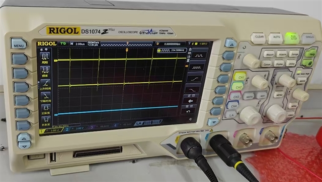

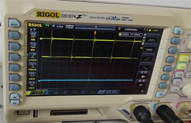

  • Good evening. When I tested this afternoon, I switched the chip to the Independent Input Mode (IIM). The test results met my expectations. In Figure 1, the yellow waveform is the waveform of LO, and the blue waveform is the waveform of HO-HS. The second figure shows the voltage across the bootstrap capacitor measured by a multimeter, which also meets the requirements. Currently, the chip works normally in IIM mode, but there are still issues in PWM mode. Thank you for your previous reply. I will gradually troubleshoot the causes of the problems in PWM mode later. If I encounter any issues, I would like to continue consulting you. Thank you very much.

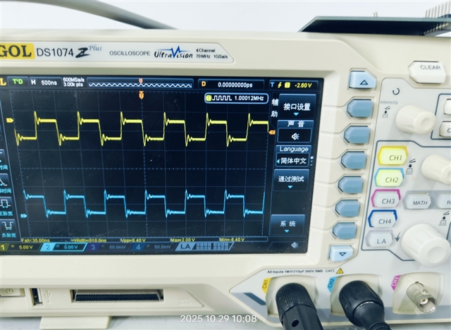

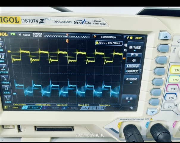

  • Hello, I have integrated the GaN device into my circuit, but I am observing behavior I do not yet understand. When only the first driver IC is powered, the HO–HS and LO outputs are normal, as shown in Figure 1. However, when only the second driver IC is powered, the HO–HS and LO outputs become distorted, as shown in Figure 2. Furthermore, when both driver ICs are powered simultaneously, no signals are observed at HO–HS or LO on either device. I am unable to determine the cause. Could you please suggest several troubleshooting approaches?Would you like me to provide the power supply’s voltage and current levels used at that time?
