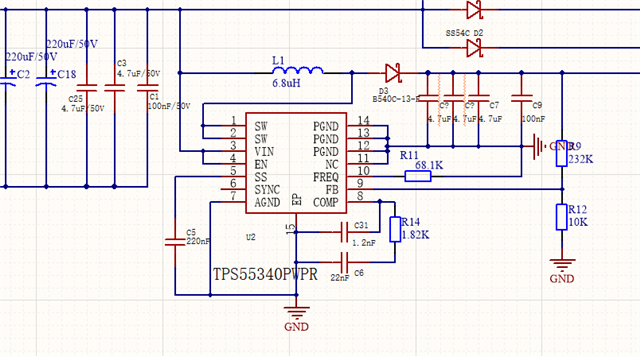

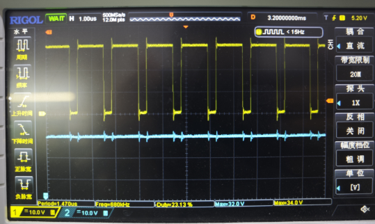

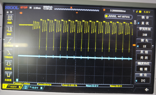

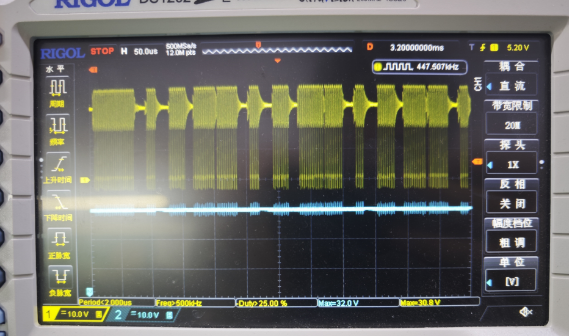

你好,我在使用TPS55340搭建升压电路时遇到的问题:24V升压到30V,使用WEBENCH设计输入22V-28V输入,30V,2A输出的设计参数搭建如图电路,带载情况下,在22V-28V都能升压并且输出,但是在高于24V输入并且空载的情况下,芯片启动之后一段时间(大概10s-30s)芯片就停止升压,SW停止开关,输入等于输出,通过芯片手册了解到在轻载的时候芯片会进入pulse skipping模式,但是在这个模式下一段时间就停止工作,是因为占空比过低导致芯片无法工作吗,我有什么解决办法吗? 电路原理图, 空载时的SW波形, 300ma负载时SW波形, 2A负载时SW波形

    The TPS55340 PWM control system has a minimum PWM pulse width of 77 ns (typical). This minimum on-time determines the minimum duty cycle of the PWM for any set switching frequency. When the voltage regulation loop of the TPS55340 requires a minimum on-time pulse width less than 77 ns, the IC enters pulse skipping mode. In this mode, the device will hold the power switch off for several switching cycles to prevent the output voltage from rising above the desired regulated voltage. This operation typically occurs in light load conditions when the PWM operates in discontinuous conduction mode. Pulse skipping increases the output ripple as shown in Figure 8-7.
    您尝试调整PWM的在以上描述以上避免进入pulse skipping模式
