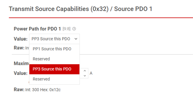

Question 1: PPHV corresponds to a bidirectional 5A current; PP5V corresponds only to the switch used when acting as a source to output externally. When TPS25751D is used as a source, can it only use the switch corresponding to PP5V to output 5V externally? Is it still possible to use the PPHV path to output power externally?

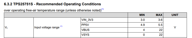

Question 2: When TPS25751D is used as a sink, it can only use the built-in bidirectional PPHV 5A switch. Are there any requirements for the input voltage and current? Does it have to be above 5V?

    Question 1: PPHV or PP5V can be used to source the 5V from the PD controller. This can be modified within the Transmits source Capabilities Register in the Application Customization Tool. PP1 is PP5V and PP3 is PPHV. See image below.
    Question 2: You are correct that when the PD controller is sinking, the PPHV power path is used to output the required PDO. The TPS25751 can handle up to 20V/5A or 100W. Please see the table from the TPS25751 data sheet for the recommended inputs voltages.
