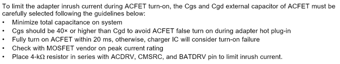

  • Can you provide scope capture of VIN and ACOK when this behvaior occurs?
    The ACFETs will shutoff, if ACOK goes low.
    These are the condition to prevent ACOK from going low.
    Can you confirm that ACOK does not go low and all these conditions are met?
  • No further response
  • Thank for your long term's reply,l've solved this problem,i reduce the capacitor value of C12&C12 to 1nF 4.7nF and the board function is ok now,i think maybe the mosfet that i choose switching speed is too low and trig the protection.Many thanks.
