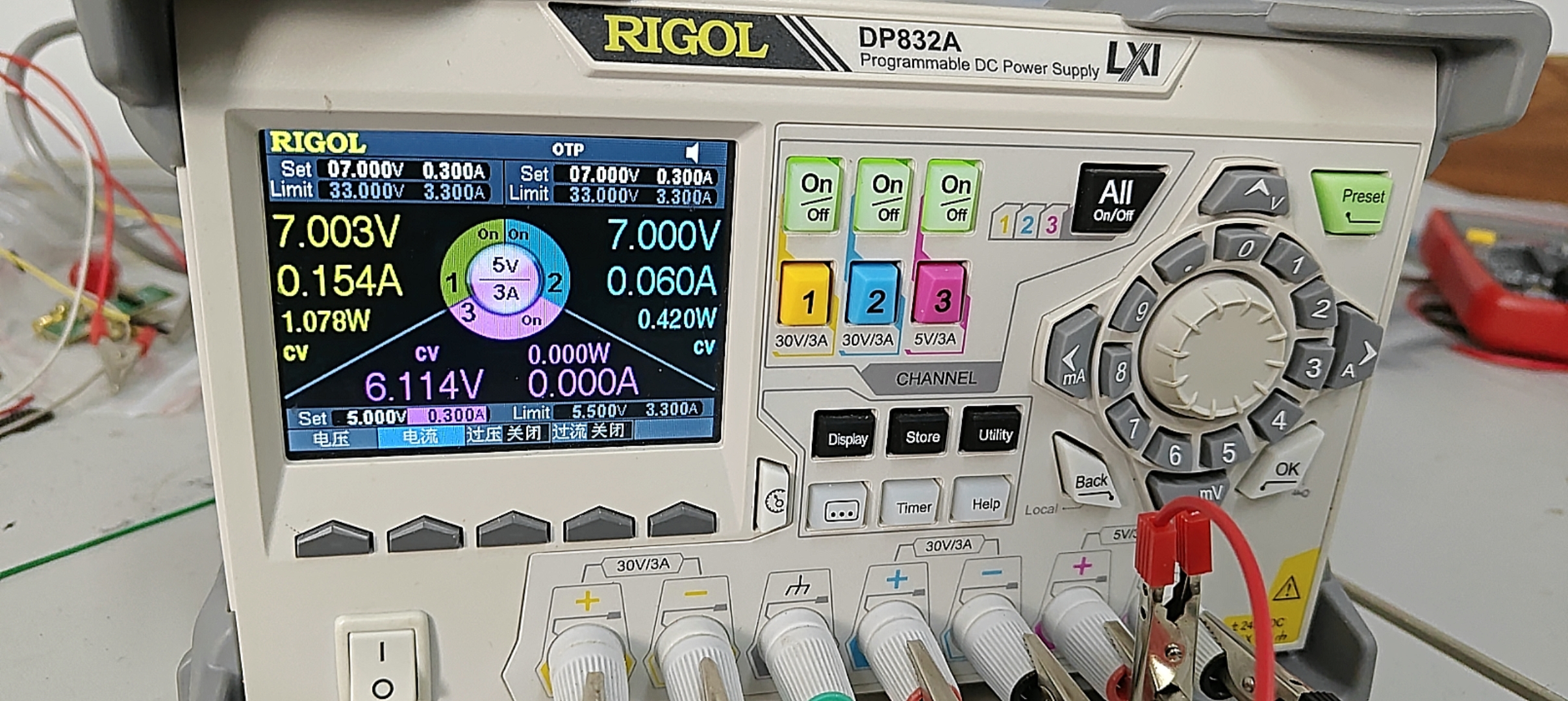

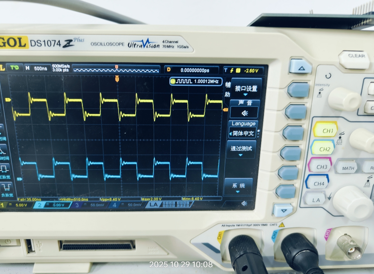

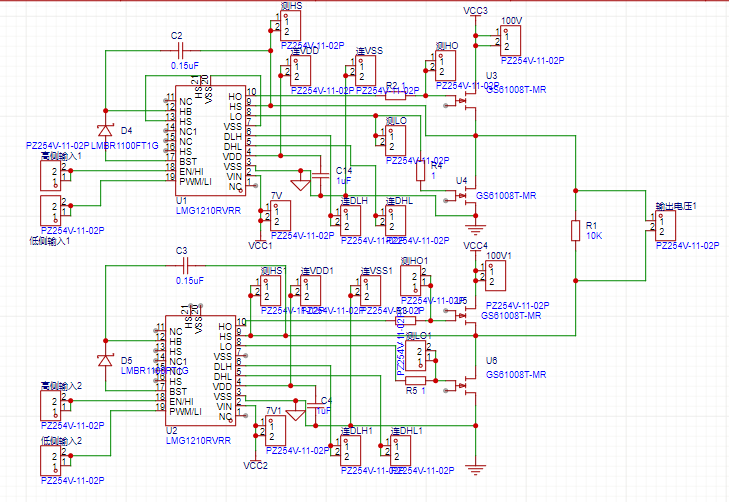

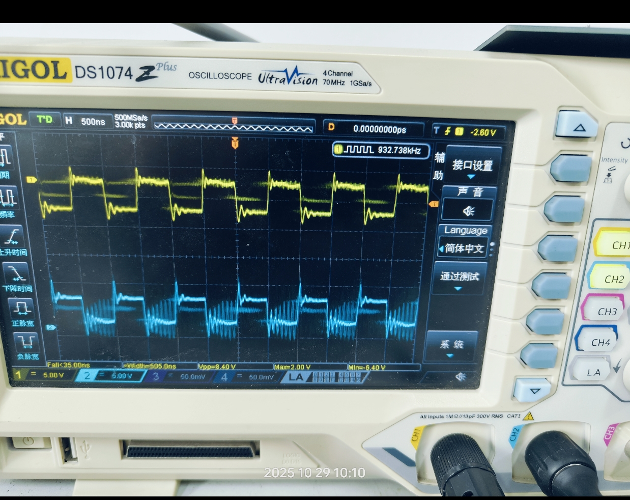

The first image shows the circuit schematic I am using. For this chip, I have chosen the IIM mode. The input signal is a pair of complementary 1MHz PWM signals generated by an FPGA. I encountered an issue: when I power only the first chip (U1) and leave U2 unpowered, the HO-HS and LO ports of the first chip (U1) show normal output, as shown in the second image. The third image shows the power generator settings and the current at that moment.

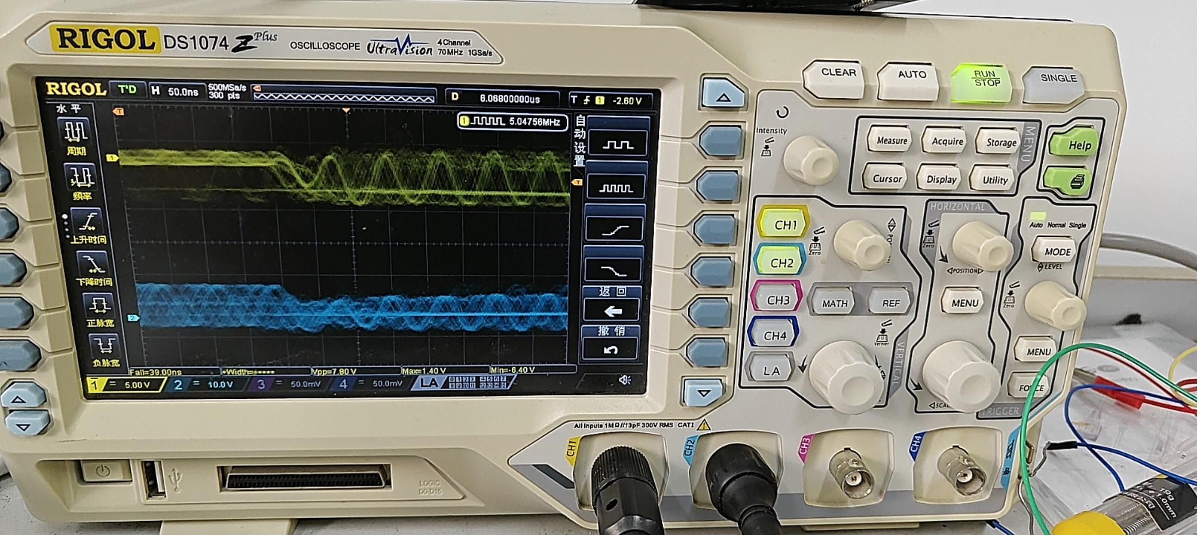

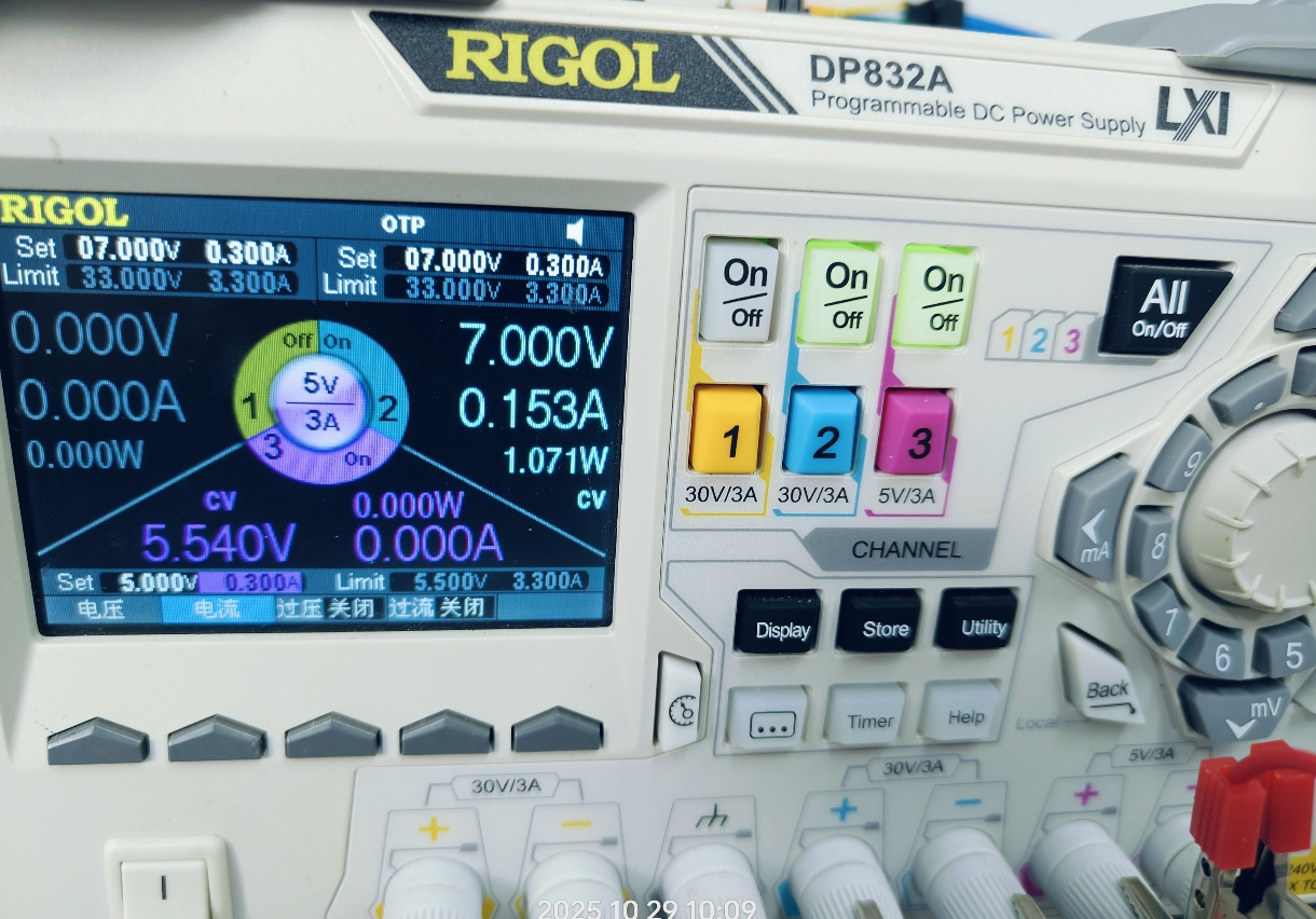

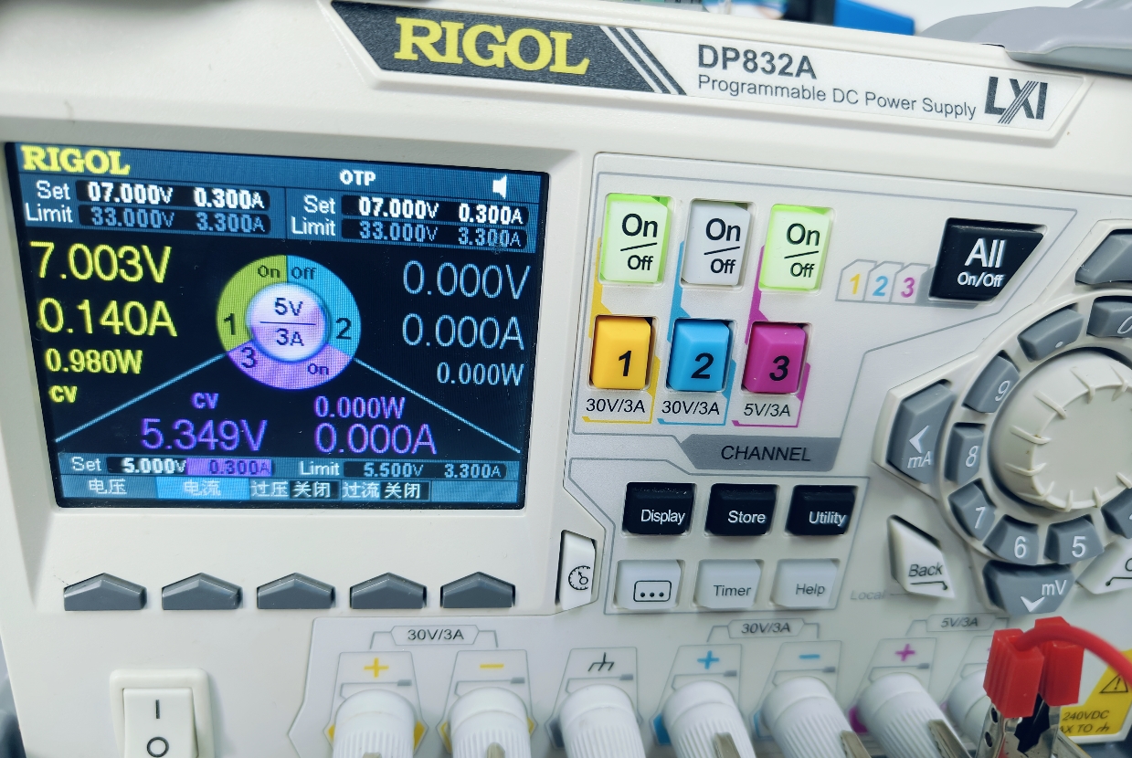

However, when I power only the second chip (U2) and leave U1 unpowered, the HO-HS and LO ports of the second chip (U2) exhibit distortion, as shown in the fourth image. The fifth image shows the power generator settings and current at this point.
When I power both chips simultaneously, no signal is observed, as shown in the seventh image. The settings and current of the power generator at that moment are shown in the sixth image.
At present, I have no clue on how to resolve this issue. Could you provide some troubleshooting suggestions?

  • Thank you for reaching out. In your schematic I see the second driver (U2) does not have the VSS, HS pins/thermal pads connected to each other like you have in first driver (U1). can you clarify if this is done on purpose?
    Can you make the connections for U2 same as U1 and check if you get the same results or waveforms on U2 as on U1?
  • I sincerely apologize for any misunderstanding caused. On the actual circuit board, the second driver (U2) is interconnected with the VSS, HS pins/thermal pad, just like the first chip.

  • Thank you for clarifying your schematic connections, can you please clarify if your DLH pin is connected to VDD? this is required to select device IIM mode, from your schematic I see it is connected to VSS. Please clarify this
    Can you also share some waveforms of the other issue you noticed. I believe since your device is not set to IIM mode it may be operating in single input mode
