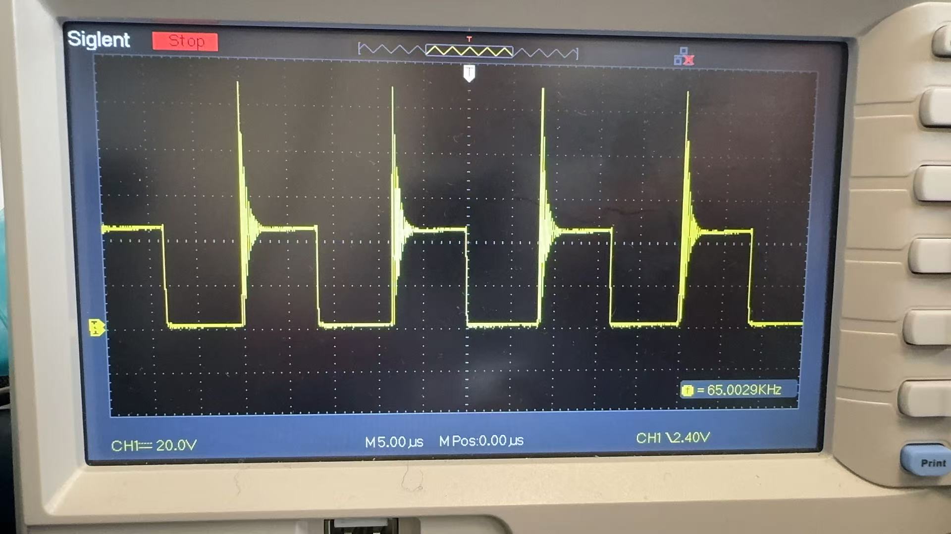

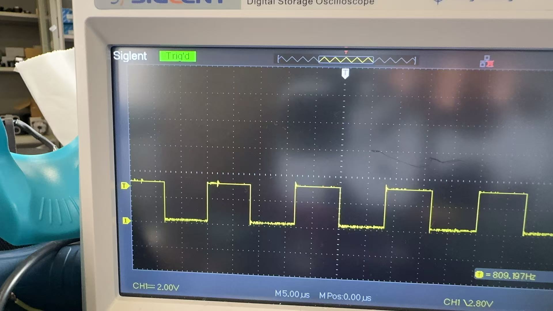

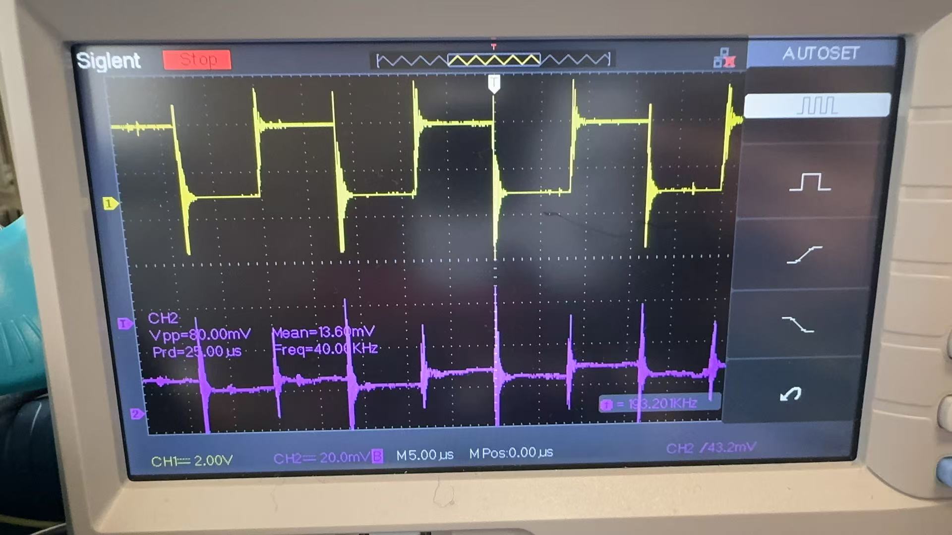

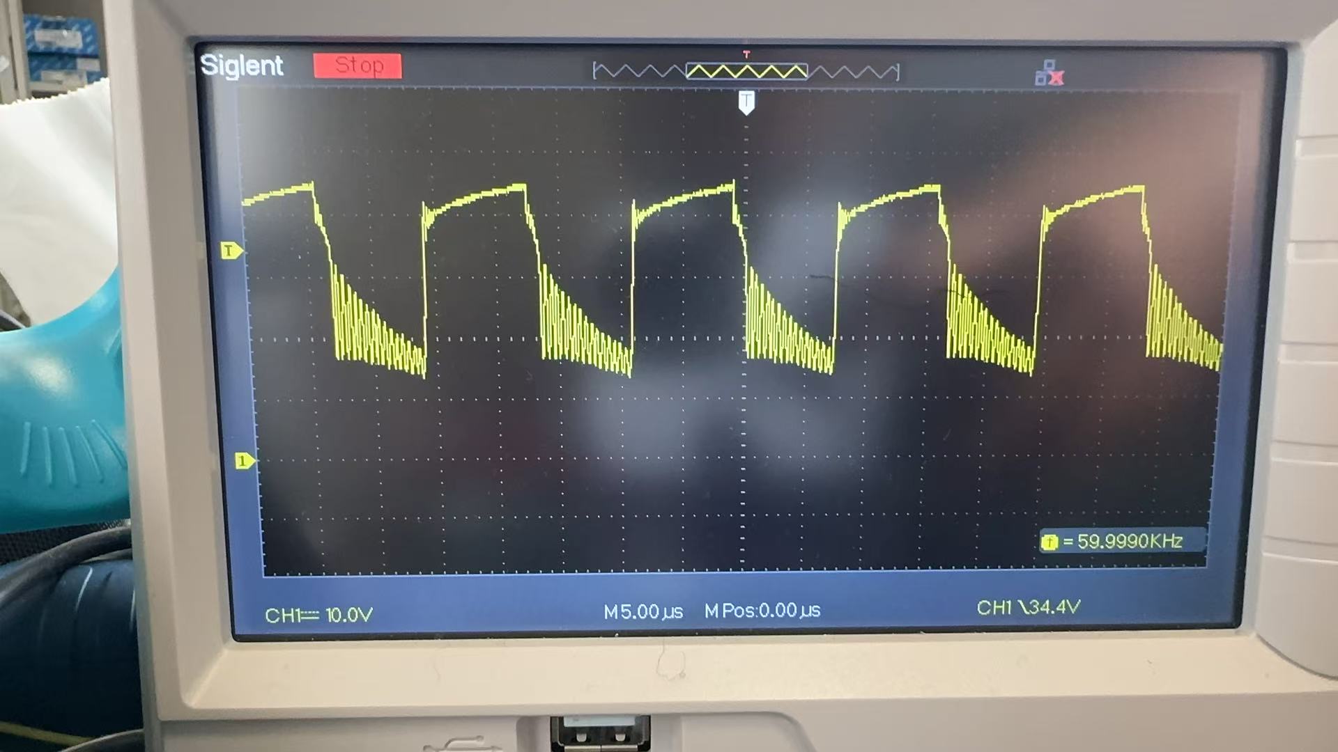

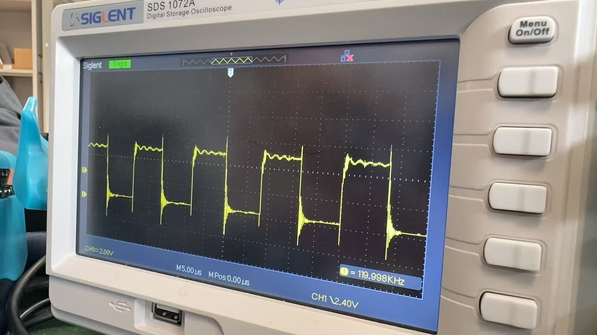

Keep the original parameters of the LM3409HVEVAL unchanged, switch J1 to Mode 2, use an external 60 kHz PWM signal for triggering, connect a load of 14 LEDs, and supply voltage via a signal generator. The following issues occurred:
  1. A huge surge voltage of up to 90 V appeared at the LED+ output, and a large surge also occurred in the PWM input signal.

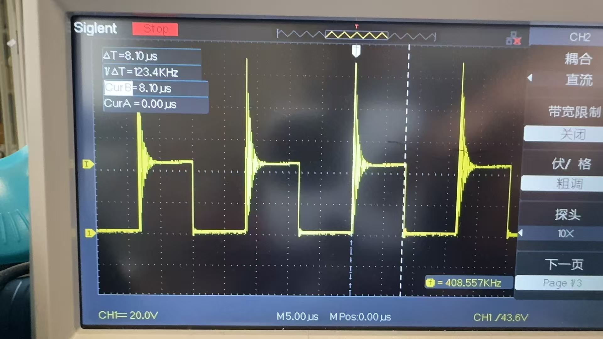

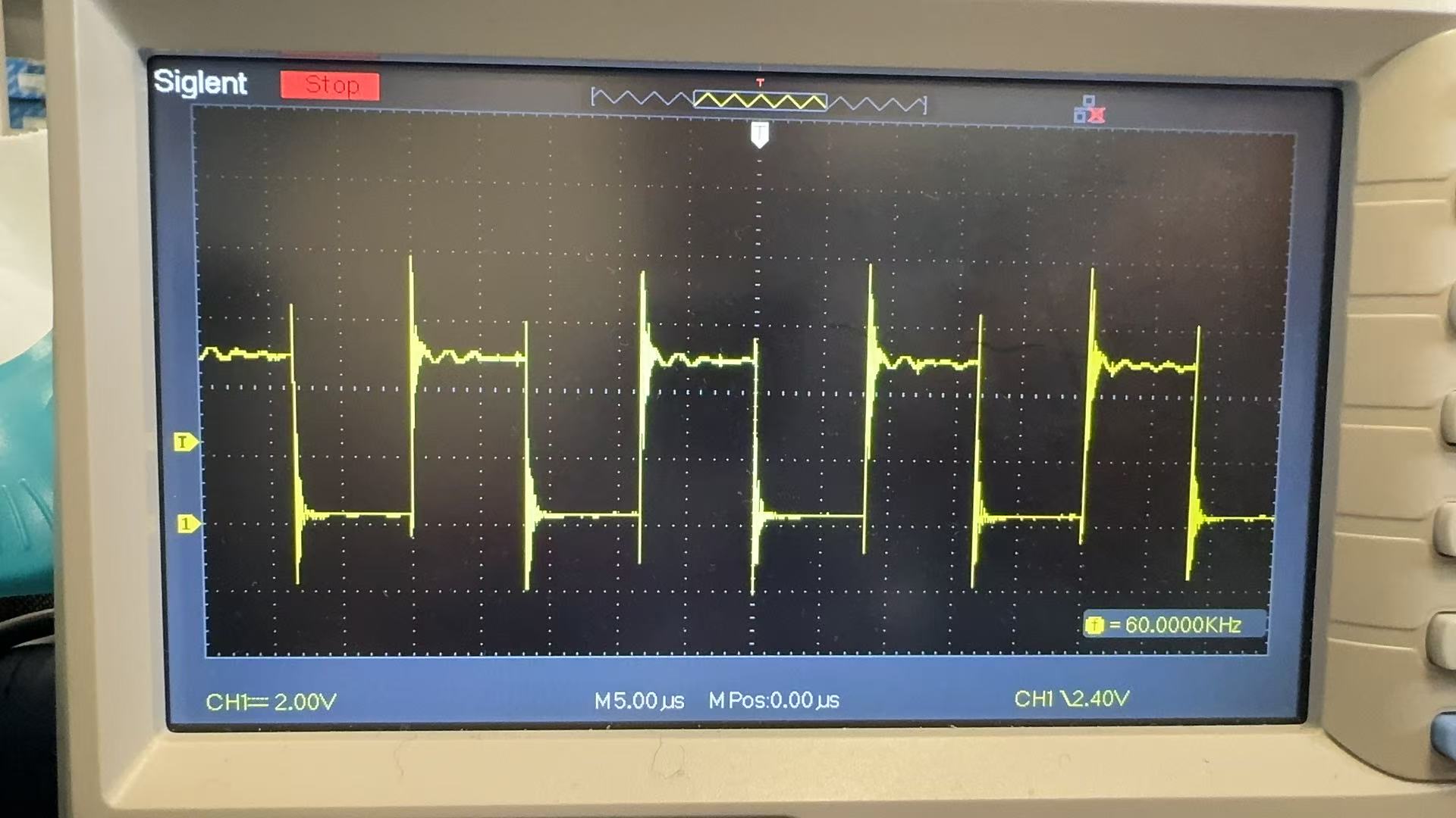

  5. The test waveforms are as follows: After changing R1 to 20 Ω and adding a 10 kΩ pull-down resistor from the G-pin of Q3 to GND, the surge at the G-pin of Q3 gradually became smooth, but the waveform at the LED+ output of the load remained unchanged.

    You may keep R1=20ohm to slow down turning off speed of Q3.  Try adding FB or small resistor between VOUT and LED ANODE. Adding small cap on LED anode to GND.
    Do you mean LM3409 got damaged if changing C8 to 22uF cap? What do you mean an inductor squeal was heard when chip got damaged? Can you capture waveform of  PGATE, Gate of Q3, inductor current and SW waveform?
    When you test the waveform, pls make sure that prober GND is connected to GND on the board. You may limit bandwidth to 20MhZ to filter high frequency noise coupled to the probe and/or use GND spring during measurement.

  • Thank you. I've resolved the load issue (the previous overshoot was caused by the load voltage exceeding the set voltage). Now I'm going to proceed with the detailed design. Could you please provide the GERBER files for the LM3409HVEVAL as a reference for my design?

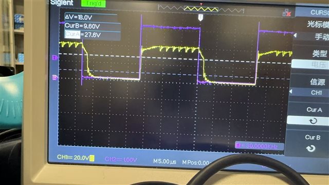

    I encountered a new issue during recent tests and want to check with you: CH1 is LED +, CH2 is the PWM input of EN pin, and there’s an approximate 2μs delay when turning off. Is this normal?
  • Hello ,
         Please request another ticket for your new issue.
