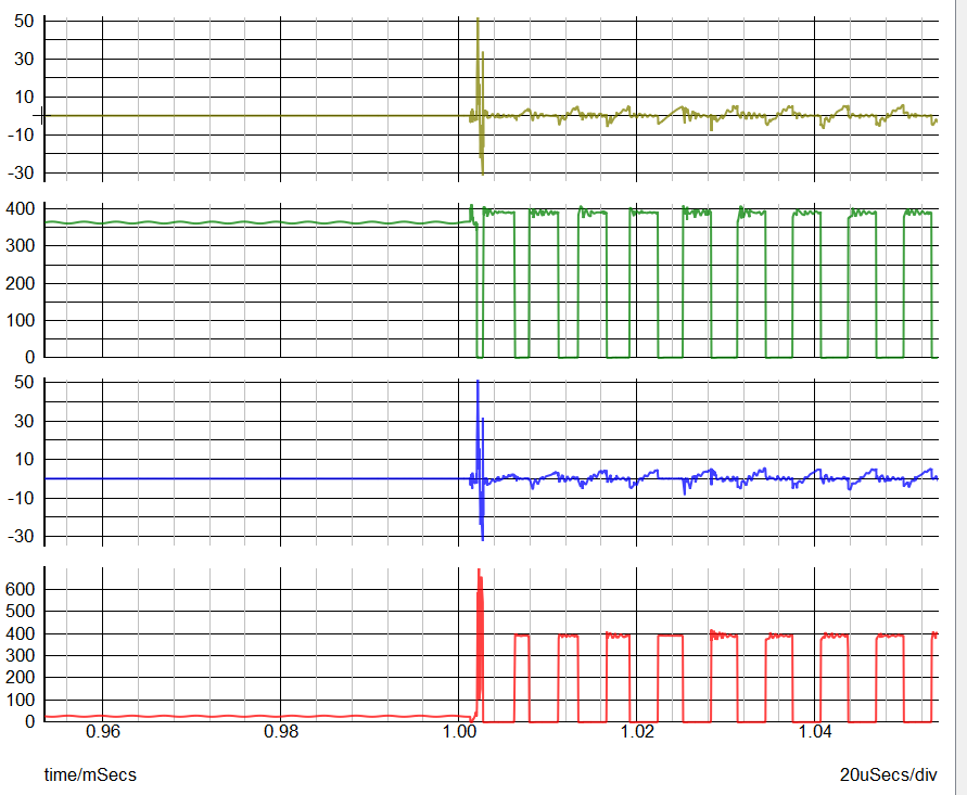

First, regarding MOSFET current and voltage spikes at startup: In simulation, when using MOSFET models, I observed large current and voltage spikes on the primary-side MOSFETs at the moment of startup. Adding a small amount of parasitic inductance does not eliminate these spikes. After reviewing relevant materials, I suspect the issue is caused by the MOSFETs' initial parasitic capacitance being zero and hard switching. Is there a solution for this?

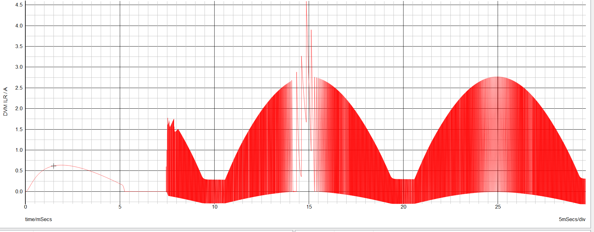

Third, regarding the UCC28056 startup issue: Sometimes, due to a small voltage difference during startup, the UCC28056 enters CCM mode, which creates an inductor current spike. How can this problem be resolved?

    增加 SS 电容或许可以减少启动时的电流尖峰。关于第二个问题,确实需要在减缓 SS 电压斜坡和 Vout 过冲之间进行权衡,但正如您所说,调整补偿参数以加快环路响应速度可以缓解这个问题。数据手册中提到了 SS 电容的最大值和最小值,只要您的环路响应速度不太慢,就不会产生明显的过冲。PFC 在启动期间进入 CCM 模式,能否提供 VDS、VBLK 和 VZCD 的放大波形?请同时提供高电平和低电平两种情况的波形图。TI方面尚未验证在单个 SIMPLIS 仿真中同时使用 UCC256404B、UCC28056B 和 UCC24624 是否可行。
