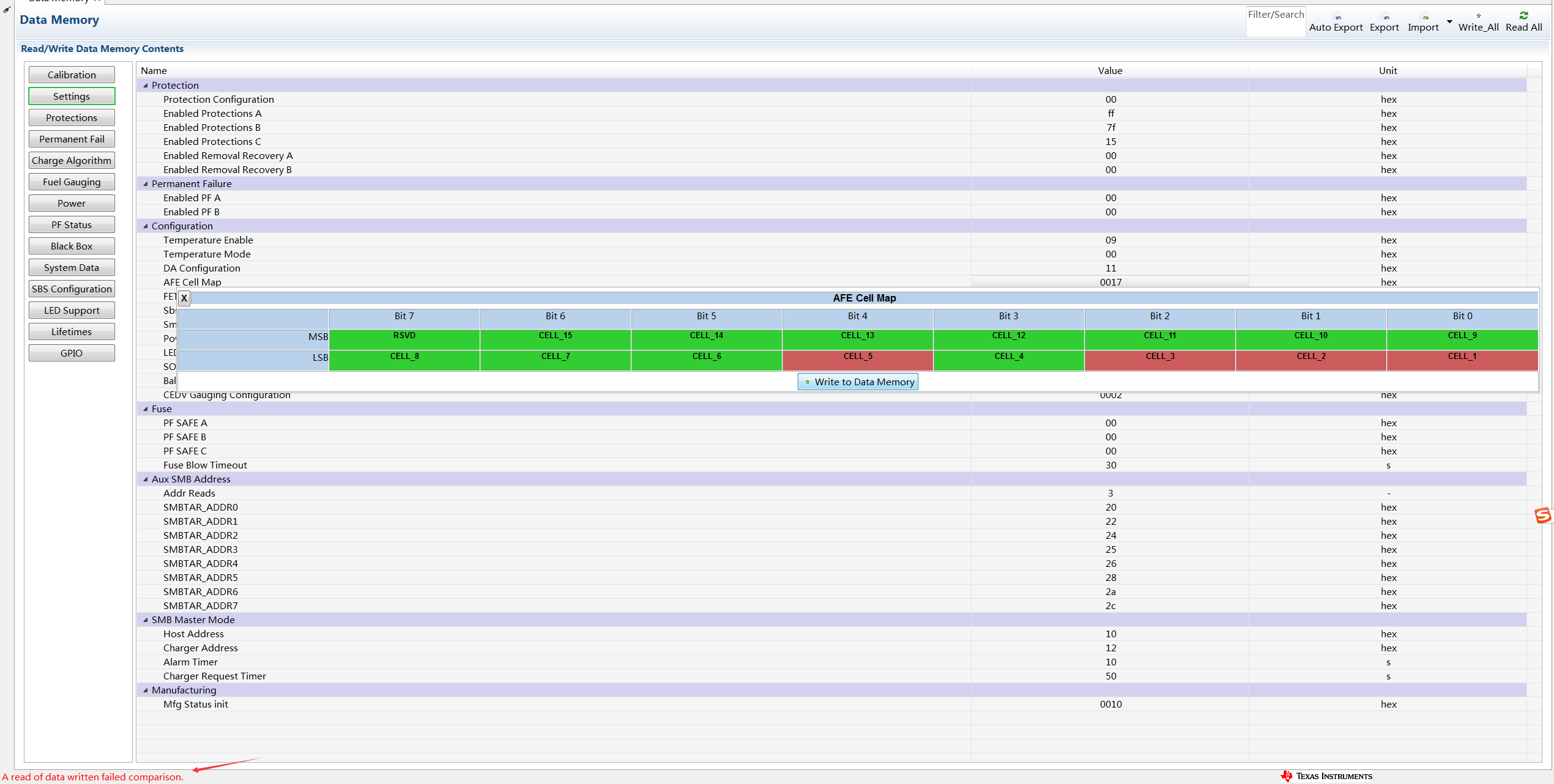

BQ78350 -R1 写入数据时:a read data written failed comparison 无法写入数据

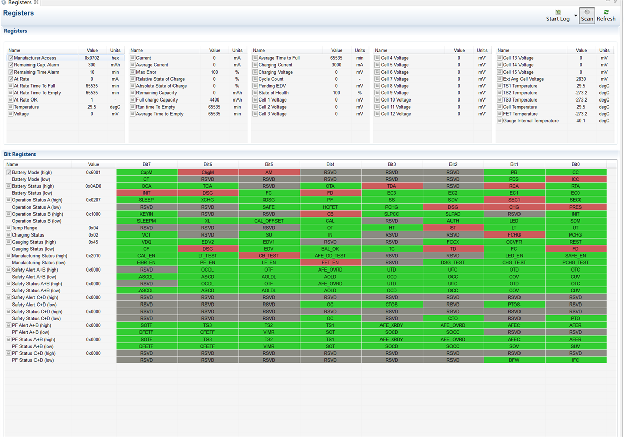

如果电池进入了保护,则无法写数据到data memory中,建议您确认下您的电池是否进入了某个保护状态  。                                                               这句话网上看到的,如果是这样,我这个怎么解决,无法使能电池组,检测电压位0V ,FD职位警告,我怎么处理?一个电池组写不进去!

    You don't indicate the value of AFE Cell Map, but indicate 1 cell, so it is probably 0x0001. If this is the case the ADC will not allow a high enough value of a single cell to meet the data flash write value. You will will be locked out of configuration changes and will need to re-program firmware. Find the firmware file for bq78350-R1 on the website and program the part. Restart bqStudio after programming, then set parameters. Be sure the bq76940 software is not running when programming, configuring, or running the bq78350.
  • 重刷固件?
