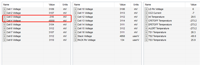

BQ76952: 将BQ76952的VC1~VC15的某一个引脚,人为断开和电芯的连接,此时断开的引脚的电压检测会有负值。
Part Number: BQ76952
Other Parts Discussed in Thread: BQSTUDIO,
如图所示,人为将VC3的引脚和电芯连接线剪断。
此时通过bqstudio读取到的Cell 3电压为-316mV、Cell 4电压为-6058mV。
理论上Cell 3 + Cell 4约等于 +6200mV 才是正确的。
请问这种情况下BQ76952内部是怎么对电压ADC值进行处理的?为什么会出现负值?

    The situation with one cell at or below 0 and the next at high voltage is common of a disconnected cell input.  Look for an open on the VC3 pin, its filter resistor or the wire to the cell.  On an EVM look for a missing or damaged cell simulator shunt. The VC3 input will float or be pulled below the VC2 input and the input will go negative.  Cell 4 reaches a maximum value then rolls over to a negative number.  The ADC is 24 bits, above 7FFFFF or 8388607 or about 6.06V, the value rolls over to 0x800000 and is a negative number.
    When the cell voltage is lower and the 2x cell voltage from the open wire does not exceed 6V the reported value stays a positive value.

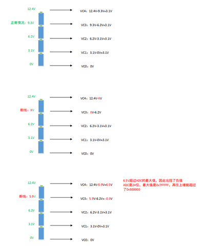

  • 您好,根据您的回答,采集线VC3断开后应该是如上图所示的情况吧。
    请问断线后的电压X,它会有个范围吗?
    我们需要对此类异常数据做一定的处理,谢谢!
  • 您好,请参考下面的内容。
    The open wire will pull down on the disconnected pin.  The lower of the cells, cell x will read about -0.3V as shown.  At lower cell voltage (up t approximately 2.9V) the upper of the cells, cell (x + 1) will read about twice the cell voltage + 0.3V up to 6V, then it will roll over to -6 V as you pictured above
