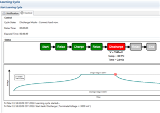

请问一下BQ27426 在learning cycle进不了 charge mode是哪里的原因?
您好,根据您给的图片来看,已经将电池放电了,但learning cycle tool仍需要确保在进行下一步之前电池放电。 您试下施加负载使其达到端接电压。放松后,请切换到 CHG 模式。
您是否已经尝试过以上步骤,但是卡住了?如果是的话,那么还需要您提供下 log file和.GG。
此外,DSG 电流阈值和 Chg 电流阈值是电量计用于切换模式的参数。 如果未检测到模式更改,您很可能没有为您的应用正确配置这些参数。 在开关模式下、还会有一个 Chg 放松时间和 DSG 放松时间的延迟。
您给出的图片看起来是在检测模式变化。
Mon Mar 21 14:36:43 CST 2022 Device Version Info = 0426_2_02 BQZ Device Name = bq27426G1 BQZ Firmware Version = 2_02 Sample,DateTime,ElapsedTime,Control,CtrlStatus,Temperature,Voltage,Flags,NomAvailCap,FullAvailCap,RemCap,FullChgCap,AvgCurrent,Qmax,AvgPower,Present DOD,StateOfChg,Int Temp,SOH,OCVCurrent,OCVVoltage,SimultCurrent,RemCap UnFlt,RemCap Flt,FullChgCap UnFlt,FullChgCap Flt,True StateOfChg,DOD0,DOD at EOC,True RemCap,Passed Charge,Qstart,DOD_Final,LogRowTime(ms),LogStatus 1,2022-03-21 14:36:49,5.330,0x0202,0x009C,30.05,3412,0x01CE,86,7621,74,7609,0,8000,0,16039,1,30.05,99,0,3413,-1,74,74,7609,7609,1,16039,608,74,0,7535,16191,1099,SUCCESS 2,2022-03-21 14:36:53,9.699,0x0202,0x009C,30.05,3412,0x01CE,86,7621,74,7609,0,8000,0,16039,1,30.05,99,0,3413,-1,74,74,7609,7609,1,16039,608,74,0,7535,16191,809,SUCCESS 3,2022-03-21 14:36:57,13.755,0x0202,0x009C,30.05,3412,0x01CE,86,7621,74,7609,0,8000,0,16039,1,30.05,99,0,3413,-1,74,74,7609,7609,1,16039,608,74,0,7535,16191,826,SUCCESS 4,2022-03-21 14:37:01,17.858,0x0202,0x009C,30.05,3412,0x01CE,86,7621,74,7609,0,8000,0,16039,1,30.05,99,0,3413,-1,74,74,7609,7609,1,16039,608,74,0,7535,16191,810,SUCCESS 5,2022-03-21 14:37:05,21.913,0x0202,0x009C,30.05,3412,0x01CE,86,7621,74,7609,0,8000,0,16039,1,30.05,99,0,3413,-1,74,74,7609,7609,1,16039,608,74,0,7535,16191,811,SUCCESS 6,2022-03-21 14:37:09,25.970,0x0202,0x009C,30.05,3412,0x01CE,86,7621,74,7609,0,8000,0,16039,1,30.05,99,0,3413,-1,74,74,7609,7609,1,16039,608,74,0,7535,16191,809,SUCCESS 7,2022-03-21 14:37:14,30.026,0x0202,0x009C,30.05,3412,0x01CE,86,7621,74,7609,0,8000,0,16039,1,30.05,99,0,3413,-1,74,74,7609,7609,1,16039,608,74,0,7535,16191,814,SUCCESS 8,2022-03-21 14:37:18,34.112,0x0202,0x009C,30.05,3412,0x01CE,86,7621,74,7609,0,8000,0,16039,1,30.05,99,0,3413,-1,74,74,7609,7609,1,16039,608,74,0,7535,16191,811,SUCCESS 9,2022-03-21 14:37:23,39.651,0x0202,0x009C,30.05,3413,0x01CE,86,7621,74,7609,0,8000,0,16039,1,30.05,99,0,3413,-1,74,74,7609,7609,1,16039,608,74,0,7535,16191,889,SUCCESS 10,2022-03-21 14:37:27,43.847,0x0202,0x009C,30.05,3413,0x01CE,86,7621,74,7609,0,8000,0,16039,1,30.05,99,0,3413,-1,74,74,7609,7609,1,16039,608,74,0,7535,16191,811,SUCCESS 11,2022-03-21 14:37:31,47.951,0x0202,0x009C,30.05,3413,0x01CE,86,7621,74,7609,0,8000,0,16039,1,30.05,99,0,3413,-1,74,74,7609,7609,1,16039,608,74,0,7535,16191,825,SUCCESS 12,2022-03-21 14:37:36,52.116,0x0202,0x009C,30.05,3413,0x01CE,86,7621,74,7609,0,8000,0,16039,1,30.05,99,0,3413,-1,74,74,7609,7609,1,16039,608,74,0,7535,16191,810,SUCCESS 13,2022-03-21 14:37:43,59.166,0x0202,0x009C,30.05,3413,0x01CE,86,7621,74,7609,0,8000,0,16039,1,30.05,99,0,3413,-1,74,74,7609,7609,1,16039,608,74,0,7535,16191,811,SUCCESS 14,2022-03-21 14:37:47,63.238,0x0202,0x009C,30.05,3413,0x01CE,86,7621,74,7609,0,8000,0,16039,1,30.05,99,0,3413,-1,74,74,7609,7609,1,16039,608,74,0,7535,16191,811,SUCCESS 15,2022-03-21 14:37:51,67.294,0x0202,0x009C,30.05,3413,0x01CE,86,7621,74,7609,0,8000,0,16039,1,30.05,99,0,3413,-1,74,74,7609,7609,1,16039,608,74,0,7535,16191,810,SUCCESS 16,2022-03-21 14:37:55,71.351,0x0202,0x009C,30.05,3413,0x01CE,86,7621,74,7609,0,8000,0,16039,1,30.05,99,0,3413,-1,74,74,7609,7609,1,16039,608,74,0,7535,16191,811,SUCCESS 17,2022-03-21 14:37:59,75.437,0x0202,0x009C,30.05,3413,0x01CE,86,7621,74,7609,0,8000,0,16039,1,30.05,99,0,3413,-1,74,74,7609,7609,1,16039,608,74,0,7535,16191,811,SUCCESS 18,2022-03-21 14:38:03,79.493,0x0202,0x009C,30.05,3413,0x01CE,86,7621,74,7609,0,8000,0,16039,1,30.05,99,0,3413,-1,74,74,7609,7609,1,16039,608,74,0,7535,16191,811,SUCCESS 19,2022-03-21 14:38:07,83.580,0x0202,0x009C,30.05,3413,0x01CE,86,7621,74,7609,0,8000,0,16039,1,30.05,99,0,3413,-1,74,74,7609,7609,1,16039,608,74,0,7535,16191,810,SUCCESS 20,2022-03-21 14:38:11,87.652,0x0202,0x009C,30.05,3413,0x01CE,86,7621,74,7609,0,8000,0,16039,1,30.05,99,0,3413,-1,74,74,7609,7609,1,16039,608,74,0,7535,16191,813,SUCCESS 21,2022-03-21 14:38:15,91.708,0x0202,0x009C,30.05,3413,0x01CE,86,7621,74,7609,0,8000,0,16039,1,30.05,99,0,3413,-1,74,74,7609,7609,1,16039,608,74,0,7535,16191,827,SUCCESS 22,2022-03-21 14:38:19,95.780,0x0202,0x009C,30.05,3413,0x01CE,86,7621,74,7609,0,8000,0,16039,1,30.05,99,0,3413,-1,74,74,7609,7609,1,16039,608,74,0,7535,16191,812,SUCCESS 23,2022-03-21 14:38:23,99.851,0x0202,0x009C,30.05,3413,0x01CE,86,7621,74,7609,0,8000,0,16039,1,30.05,99,0,3413,-1,74,74,7609,7609,1,16039,608,74,0,7535,16191,809,SUCCESS 24,2022-03-21 14:38:27,103.938,0x0202,0x009C,30.05,3413,0x01CE,86,7621,74,7609,0,8000,0,16039,1,30.05,99,0,3413,-1,74,74,7609,7609,1,
您好,您的充电电流阈值似乎设置为大约 150mA ,因此需要在 60 秒内以超过 150mA 的电流充电才能进入充电模式。 log看起来不是实际充电的,最好能够提供整个周期的log,以便我们可以看到模式转换。

你好,上面上传的LOG就是放完电之后,硬件端是实实在在有1.6安培的电流充电给电池,但BQSTUDIO电池学习训练界面没显示进入到充电的界面
您好,您之前给出的log中,在标志寄存器中, DSG 位被清除,因此电量计是正在进入充电模式的。 实际上,在 CHG 模式下的时间比在您发送的第一个log中的时间长。 因为已经进入了充电模式,目前的问题是bqStudio 无法识别 CHG 状态? 因为电量计目前处于 CHG 模式。
你好,您的意思是DSG位被清零是进入充电模式?bqStudio 才能识别 CHG 状态?
您好,工程师这边想跟您确认下,您希望的操作是什么以及与什么相关?这样我们再求助更了解bqStudio 的同事。 仪表目前正在进入充电模式。 您是否可以分享完整的充电和放电周期,以便我们可以看到模式转换?
