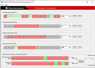

  • SMBD, SMBC 連接EV2300並使用 "Evaluation Software Version 1.0.6" 進行Register的修改

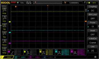

  • 您好根據  的回應這是我的回覆以及補充的資料
    1. How are they testing it? What do they have at the battery terminal?
    For our testing, we don't connect the battery cell, so only C13~C15 are connected, and the VBAT part is opened.
    (I follow the "2.4.2 Charger Parameters Setting" part fromBQ24707EVM User's Guide)
    2. If input is present, can they sink current on VSYS?
    For the input power, I check the Power supply it seems no sink much current to VSYS, just give the enough current to boot the IC.

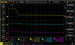

    3. Please show waveforms with ACN, SRN, PHASE, and IBAT.
    Because we don't connect the battery, so it shall be 0 A. (If need to check I can supplement)
    CH1 : ACN
    CH2 : PHASE
    CH3 : SRN
    (ACOK : PASS, IFAULT : FAIL)
    For the BQ24707 register setting just the default value.

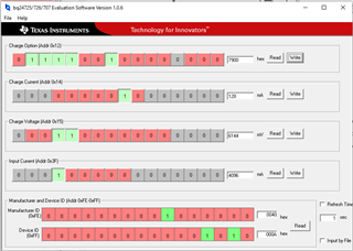

    When the voltage is stable, I change the Register as below:
    (Disable the ACOC protection)
    (ACOK : PASS, IFAULT : PASS)
    But it don't have any change
    Disconnect the power supply
    If there has any missing please tell me I can supplement as soon as possible.

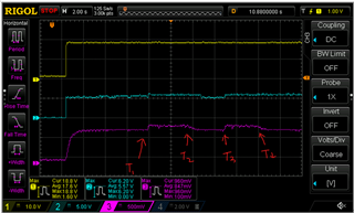

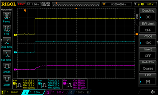

    I have checked the some PINs by the SCOPE:
    • CH1 : ACP
    • CH2 : BTST
    • CH3 : HIDRV

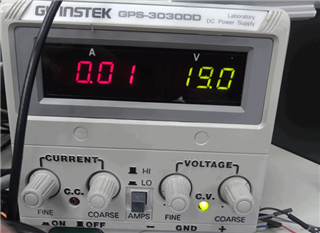

    Connect the Power supply (19 V, 0.5 A)

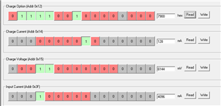

    I set the register as below, and I Enable & Disable Charge 2 times.
    Found the HIDRV increased some voltage, and then I disable again and the HIDRV dropped.
    • T1 & T3 : Enable Charge
    • T2 & T4 : Disable Charge
    But the BTST and HIDRV are not increase to higher than VCC, and don't occur the PWM wave.
    If you have any suggestion please tell me, thank you!

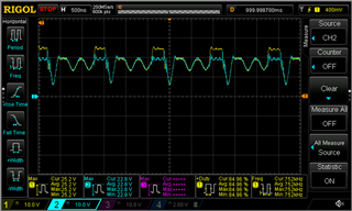

  • 您好,我經過測試後發現
    造成BTST以及HIDRV輸出不正確的問題似乎是MOSFET的問題
    我原本是使用BSZ160N10NS
    後來改用TPC8406-H
    可以解決無法正確調整ChargeVoltage的問題

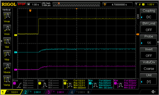

    以下是在Discontinuous Conduction Mode (DCM)量測PHASE以及HIDRV的波形圖
    (沒有接上電池)
    CH1: PHASE CH2: HIDRV
    跟Datasheet進行比較看起來正確的
