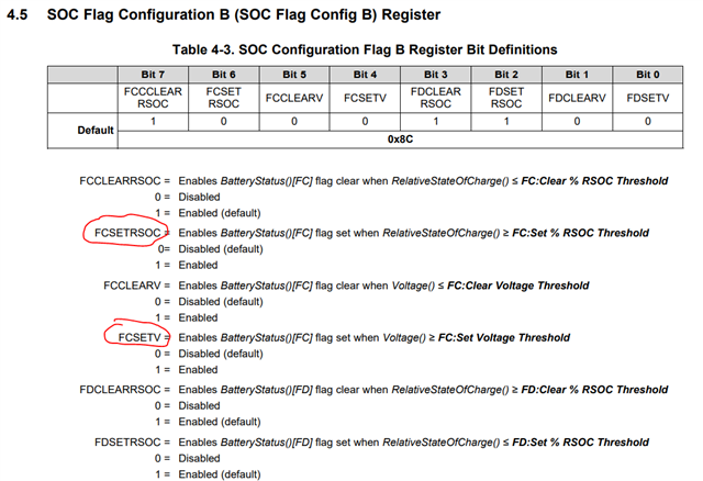

  • 您好,正常查询,稍后回复。
  • 您好,FC can be set in two ways, depending on the SOC Flag Configuration B (SOC Flag Config B) Register.
    1-  If FCSETRSOC is set in (SOC Flag Config B) AND RSOC is greater or equal than FC_Set_RSOC, then FC = 1
    OR
    2-  If FCSetV is set in (SOC Flag Config B) AND cell voltage is greater than FC_set_voltage, then FC = 1
    Right now it looks like the customer has it configured by default, and neither are selected. Please see below
  • Hi Star,
    感谢回复,
    不过并没有解决问题
    就如回复的内容一样 SOC Flag Config B里面的
    FCSETRSOC=0, FCSETV=0, 这个是默认值没有问题吧?
    所以FC跳变到1的原因不是这2个设定
    不明白要我看SOC Flag Config B的目的是什么?
    在SOC Flag Config A里面已经是FCSETVCT=1
    问题是VCT的条件没到FC就=1了
  • 您好,上面发的内容提到FC设置有两种方式,请将FCSETRSOC=1, FCSETV=1

  • 您好,FCSETRSOC=1, FCSETV=1您选择一个置1,如果设置FCSETV=1,您看一下FC Set Voltage Threshold
