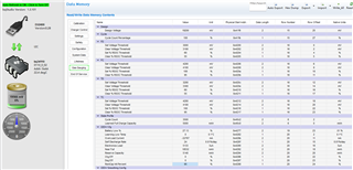

配置剩余容量RemCap lnit Percent为100%,左边状态栏显示只有9%~10%,是什么原因
您好,The initial RC is estimated using the voltage characteristics of the programmed battery voltage table (see Voltage 0% DOD through
Voltage 100% DOD) and Learned Full Charge Capacity.详细请参考TRM 2.7.10 Initial Battery Capacity at Device Reset
