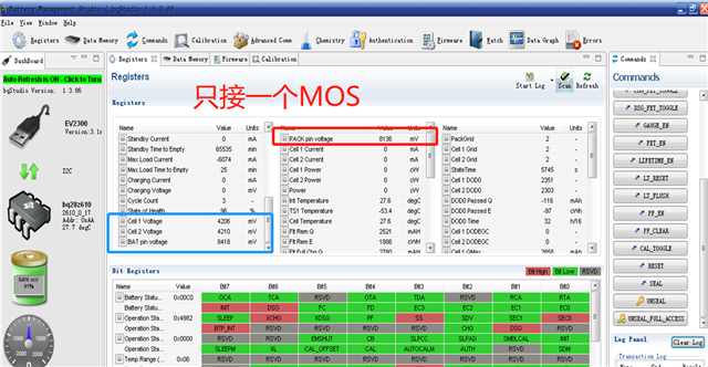

BQ28Z610: BQ28Z610 2串
Part Number: BQ28Z610
Other Parts Discussed in Thread: BQ40Z50-R1
    TI工程师好

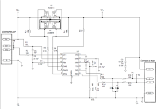

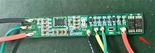

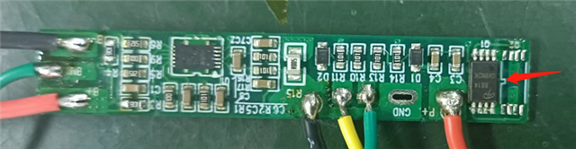

   2串电池用BQ28Z610,用1个tssop-8的MOS和用两个tssop-8的MOS并联 ,过充保护后测试到的电压不一样;

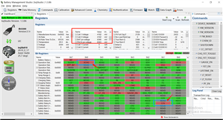

   1、只用一个MOS,软件上显示电压为8.136V,用FLUKE测得电压和这一样;

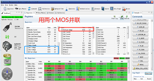

    2、只用两个MOS并联,软件上显示电压为8.539V,用FLUKE测得电压为8.8V左右,电压是跳动的;
请问下为什么会这样,同一个板子只有加一个MOS就出现这个情况了。请帮忙分析下,
  • 您好,能将电路发过来看一下吗?并联的MOS是哪个MOS
  • MOS管用的是AO8814
  • 您好,由于问题比较复杂,我需要询问更了解这款芯片的TI工程师,再帮您解答,稍后回复。

  • 1、1个MOS不满足工作电流就搞两个并联用,
    2、现在不是驱动不了的问题啊,是过充电保护了(XDSG置1),用的MOS数量越多,输出端的电压越高,MOS关不了?
    2、BQ40Z50-r1用3对MOS也没有这现象啊,

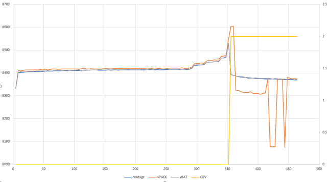

  • 我是说用两个mos ,是因为产品工作电流1个mos不够的时候才用两个,
    然后为什么过充保护了就出现输出电压不对?

  • 您好,From the pictures above, I can only see few responses from the gauge. Do you have a log file which describes this scenario?
    I have couple of questions, from the schematic above I do not see any protector. If no protection is being used in the schematic, did you disable the protections under Settings: Enable Protections A and Settings:Enable Protections B?
    Can you share the log and gg file?
  •  2S.gg.csv
    XCHG不是充电MOS管关闭了?
    gg文件已上传

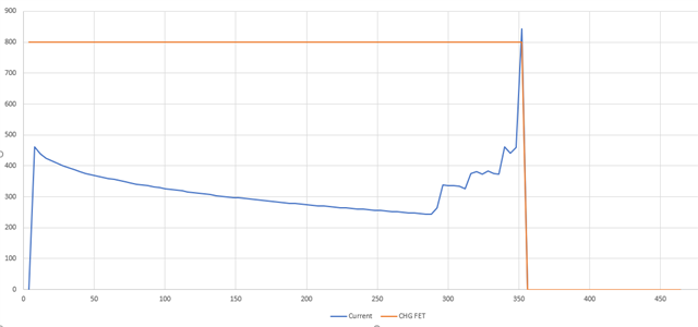

  • 您好,From gg file, I can see that Overcurrent in Charge protection is enabled. From the above schematic, I do not see any protector. This is a problem, the gauge will act as if protectors are part of the system.
    I suggest disabling the Overcurrent In Charge Protection if not protection is being used, or even disabling protections if not used at all. Or, increasing OCC:Threshold if current is greater than this threshold.
    I will need a log file to provide more details, but essentially if the current is greater than OCC:Threshold for OCC:Delay duration, this will trigger Overcurrent in Charge Protection.

    软件显示是COV,不是OCC。
    LOG的数据,上位机显示的界面,万用表测试到的电压。

  • 您好,Looking at the log file, I see the gauge is working as expected. When Charge FET turns off (due to COV), the current sensed by the gauge at BAT side immediately drops to zero. The gauge is doing what is supposed to do. Please see below
    The gauge uses Voltage sensed at V-Bat side to preform its gauging algorithm. So, I don't think this will cause any issues as for the gauging aspect. Please see below.
    Looking at the image above, I see that V-Pack is stable until COV. At COV event, the gauge opens the CHG FET and no charging current is allowed. This is what is expected from the gauge point of view. Any measurement after COV is not relevant as the gauge will ignore this.
    Notice how Vpack is bouncing up and down, this is the reason why your FLUKE measurement is different from what the gauge reports.
    Have you tried measuring VPACK before COV? It looks like VPACK is very stable before COV.
    I would also double check the parallel FET connections. Please read the below app notes which reference to parallel FET applications.
    https://www.ti.com/lit/an/sluaa09a/sluaa09a.pdf?ts=1666972968324&ref_url=https%253A%252F%252Fwww.ti.com%252Fproduct%252FBQ76952
    https://www.ti.com/lit/an/slva729a/slva729a.pdf?ts=1666973248359&ref_url=https%253A%252F%252Fwww.ti.com%252Fproduct%252FBQ76200
