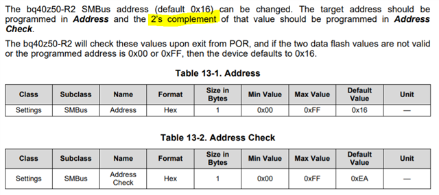

请问,Battery Management Studio可以修改smbus地址吗?对应的是哪一个寄存器

您好, The address should be programmed in the Smbus > Address DF value, the 2's complement should be programmed in the address check.
比如地址 0x16 改为 0x1a
Default:
0x16 = 0001 0110
2's comp = 1110 1010 = 0xEA
New address:
0x1A = 0001 1010
2's comp = 1110 0110 = 0xE6
您好,地址修改以后点击write写入,或者按enter键写入。
您可以参考下面链接的内容,确认新地址可以正常打开BQSTUDIO
