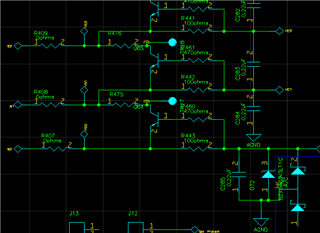

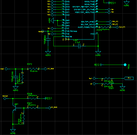

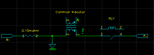

如下图设计方案,B0通过采样线直接连接BAT-,AGND通过功率回路的检流电阻(0.15mR)连接到BAT-,在大电流充电时VC1的采样电压总是会变低0.3~1.5V不等,从而触发低压相关保护。

BAT-, VC0 and Vss should all be referenced to roughly the same potential reference point. So Vss should be connected to BAT-. I can see that Vss is referenced after the sense resistor, in other words to PACK-. We recommend to have VSS referenced to BAT-. We've seen issues if Vss is referenced to PACK- for some customers.

Can they measure the voltage directly from the pins to Vss, so VC1 to Vss, VC0 to Vss, VC1 to VC0 during high charging and see if it matches the measurements by the IC. They mention they see a voltage difference between 0.3-V to 1.5-V, is this related to the amount of current? Or it varies randomly?
At what currents do they see the issue?
Is there any voltage drop on the traces themselves?
