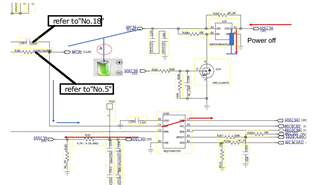

参考如下电路,通过load sw 关闭 Fuel gauge电源Vcell_in以后,因为电池电压的存在,SRP pin还有电池电压。
此时会在Fuel gauge BATpin测试到一定的电压(约0.5V),其中U35 load sw off状态时 Vout存在放电电阻(280Ω)。
想让你帮忙确认,红色路径的漏电是否存在?原因是什么?实际测试发现电池有大约3mA漏电。

您好,请参考下面内容
This looks like it's violating the abs. max. (VBAT + 0.3V). The gauge has ESD protection diodes hence if you forward bias them with a circuit that violates abs. max., you'll measure excessive current (and risk permanently damaging the part because those structures aren't designed to carry 3mA).
您好,请参考数据手册7.2 Functional Block Diagram
