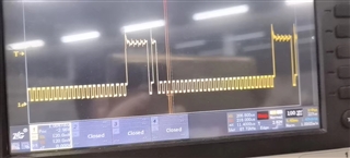

1. When the chip is powered on, the BLANK is directly pulled up, and some pins still have outputs (at this time, the program has no control).
2. Use the program to drive the IC, and the IC output does not change at all, as it did at the initial power on.
3. The MCU driver waveform is very strange(SCLK).

void SendData(int *temp)
	int i,temp1,temp2;
	BLANK(1);
	for(i=287;i>0;i--)//288
		temp1=1<<(i%12);
		temp2=temp[i/12]&temp1;
		if(temp2==temp1){SIN(1);}
		else {SIN(0);}
		SCLK(0);
		delayus(200);
		SCLK(1);//上升沿
		delayus(200);
		WWDG->CR = 0x7e & WWDG_CFGR_WINDOW;
	SCLK(0);
	XLAT(1);//上升沿移入锁存器
	delayus(200);
	XLAT(0);//
	delayus(200);
	BLANK(0);
