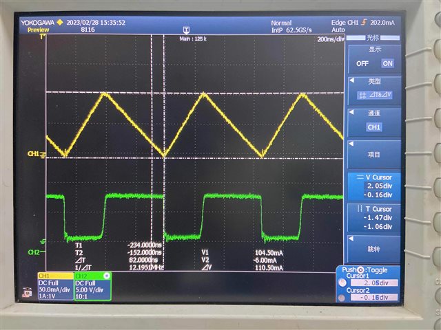

LMR64010: The inductive current in oscilloscope test is negative
Part Number: LMR64010
Design requirements:
Input voltage : 4.5V-5.5V
Output voltage : 7V
Output current : Imax=50mA

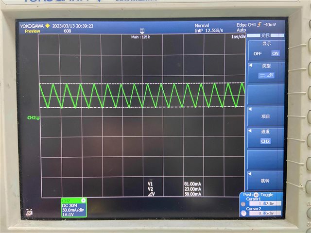

When using 10uH inductors, the inductor current is negative. I wonder why? Is there a problem with actually using this?
When using 20uH inductors, the inductor current is normal
