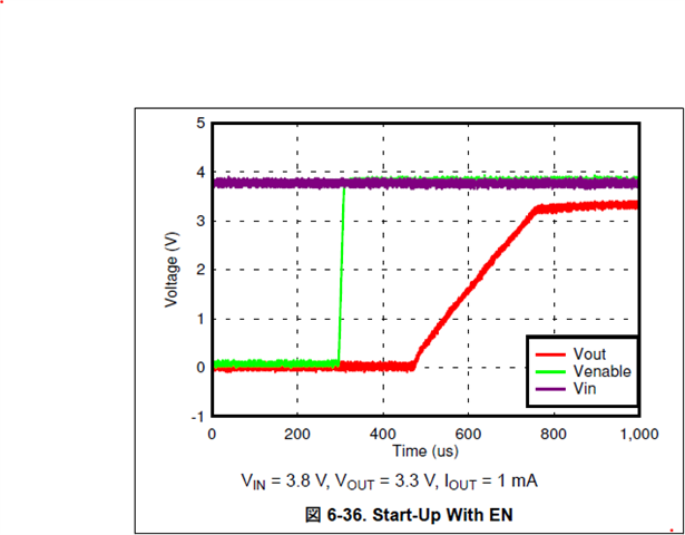

The load equipment requires the rise time of the power to be greater than 0.15ms
I would like to inquire about the deviation of rise time for TPS745-Q1 .

A rise time greater than 150us should not be an issue with this device, as the lowest rise time this device is guaranteed for is 200us:
The start-up time defined in the datasheet includes delay time an rise time
The delay time is about 200us from fig 6-36.
In limit condition, Can device guaranteed the lowest rise time of 200us?
Since the start-up time includes delay time and rise time, then yes, we should be able to guarantee the lowest rise time is 200us.
