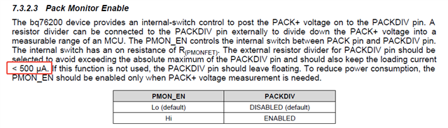

How to understand that the loading current should be less than 500uA, and what will happen if it is greater than 500uA?
