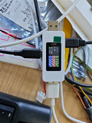

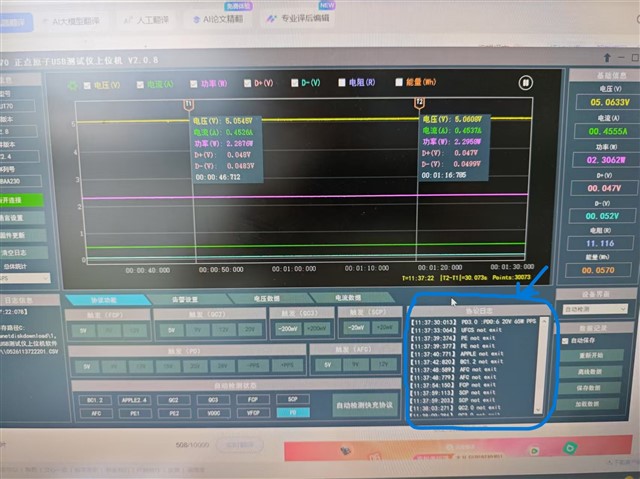

We have created a bin file that can be written to EEPROM using USBCPD_application_Customization Tool. After entering the file, when we first insert the battery and then insert the USB PD charger, there will be no current at the USB PD charger, only voltage, as shown in the figure 1.
fig. 1
When we first insert the USB PD charger and then insert the battery, the battery will resume charging, as shown in Figure 2.
fig. 2

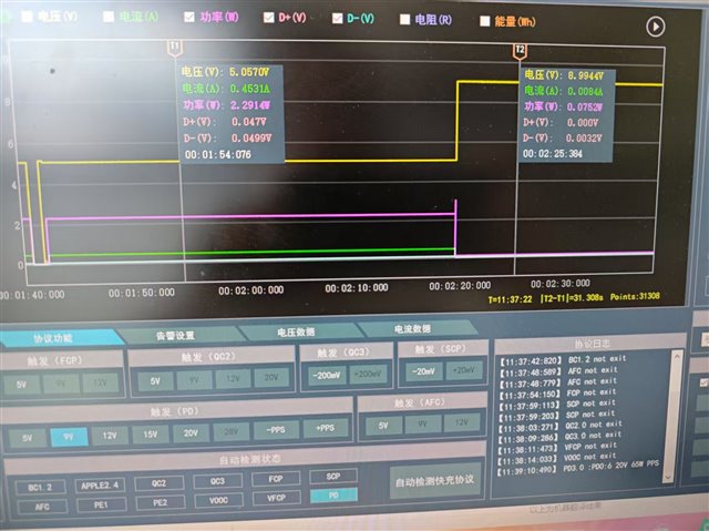

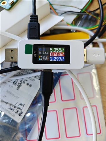

Another issue is that after the battery is charged, the charging protocol does not seem to charge according to the USB PD protocol. From the content shown in Figure 1 and Figure 2, the charging type is APPLE2.4 or BC1.2 (both situations may occur). But when we use a USB tester for testing, we can find that the configured charging protocol is USB PD, as shown in Figure 3.
fig. 3
However, when we attempt to change the output mode to PD and raise the voltage to 9V, the battery will no longer charge, as shown in Figure 4.
fig. 4

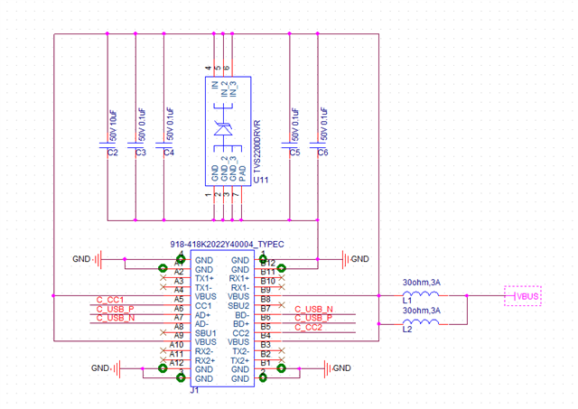

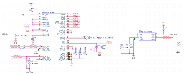

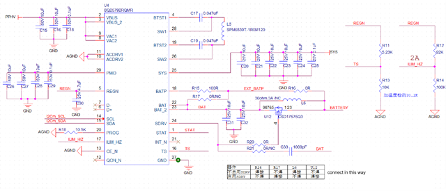

The circuit diagram of TPS25750 is shown in Figure 5 and Figure 6, and the circuit diagram of BQ25792 is shown in Figure 7. We believe that the probability of TPS25750 configuration errors is higher. When the device is connected to the battery but not to the charger and the BQ25792 module ADC register is opened through I2C, we found that the values are normal except for the input voltage. However, when the USB PD charger is inserted, the input voltage is still 0. In addition, when we tried to directly connect TYPE-C input to BQ25792 and found that this was feasible in a short period of time, but it caused severe overheating.

  1. When the module is connected to the battery first and then to the USB PD charger, the module will encounter a problem of not being able to charge. Is it a configuration issue with the bin file generated by us using USBCPD_application_Customization Tool? If that's the case, how should we configure it? Or should I use I2Cs to configure TPS25750?
  2. When the module is configured to charge in USB PD mode, the charging method is not USB PD. Is there a configuration issue with the bin file generated by us using USBCPD_application_Customization Tool? If that's the case, how should we configure it?

    Thank you very much for your support. However, based on the phenomenon, I believe that the possibility of this issue being caused by abnormal hardware circuits or programs in BQ25792 is extremely low.
    In addition to the phenomenon described in the previous post (software can read the degree of BQ25792 register when not charged, and only BQ25792 can be charged when TPS25750 is not placed), we have other evidence pointing to BQ25792 working normally.
    We have read the register readings of the BQ25792 module when the battery is charged (I=500mA) and when it is not charged (I=0A) (see attachment), and we believe that the module should be able to charge normally in both register configurations.The phenomenon described at 0A is more like BQ25792 being ready but not receiving input voltage(voltage was not measured directly at VBUS in Figure 6).
    Another phenomenon that can explain the problem is that when I briefly short circuited 3.3V and GND on the entire board, the module was able to return to normal charging state, which seems to be similar to the TPS25750 module entering the 'PTCH' mode.
    Of course, there may also be issues with the BQ25792 setting, as register 0x1C displays the connected charger type as "Unknown adapter" during charging. If some assistance can be provided in this regard, it would be very helpful.
