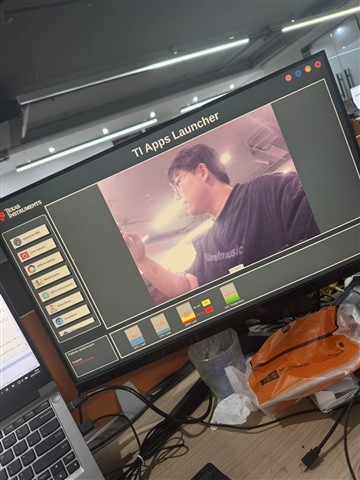

  • Thank you very much. Looking forward to your reply. Additionally, I found that using the ti app launch live camera feature allows for previewing. This should indicate that there is probably no major issue with my camera configuration.
    I need the complete command that can ensure stable preview when using the gst command. Thank you.
    If you need me to provide other source codes, please let me know.

    Thank you for your reply. This seems not to be possible.
  • Hi,
    When using 640*480 resolution you are getting the error,
    kmssink, the "Permission denied" error is almost certainly due to another application—most likely a display server or compositor like Weston—already controlling the graphics hardware resources (the KMS/DRM planes).
    1. Assuming your system is using systemd to manage services, you can stop the Weston display server using the following command:
    systemctl stop weston
    2. Rerun the GStreamer Pipeline. Once the service is stopped, run your successful 640*480 pipeline again:
    also try the same pipeline with alternative sinks waylandsink , autovideosink.
  • Thank you very much. It turns out that I need to turn off Weston in order to use Autovideosink and be able to preview. However, I still have another issue. It seems that I can only preview at a resolution of 640x480, and the colors are a bit too red.
