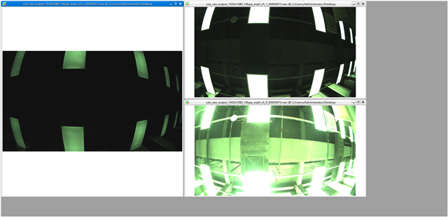

Saved data:
Writing /opt/vision_apps/app_cam_out/csix_raw_output_1920x1080_16bpp_exp0_ch_0_00000245.raw ..
Done!
Writing /opt/vision_apps/app_cam_out/csix_raw_output_1920x1080_16bpp_exp1_ch_0_00000245.raw ..
Done!
Writing /opt/vision_apps/app_cam_out/csix_raw_output_1920x1080_16bpp_exp2_ch_0_00000245.raw ..
Done!

Current Status
Currently, by modifying Configuration 2, I can successfully capture the Long, Medium, and Short exposure data from the SC2210 sensor. These are output via three independent channels (CH0, CH1, CH2) corresponding to the first exposure frame (exp0).

    Saved data:
    Writing /opt/vision_apps/app_cam_out/csix_raw_output_1920x1080_16bpp_exp0_ch_0_00000473.raw ..
    Done!
    Writing /opt/vision_apps/app_cam_out/csix_raw_output_1920x1080_16bpp_exp0_ch_1_00000473.raw ..
    Done!
    Writing /opt/vision_apps/app_cam_out/csix_raw_output_1920x1080_16bpp_exp0_ch_2_00000473.raw ..
    exp0_ch_0, exp0_ch_1, and exp0_ch_2 store the long, medium, and short exposure data from the sensor, respectively.

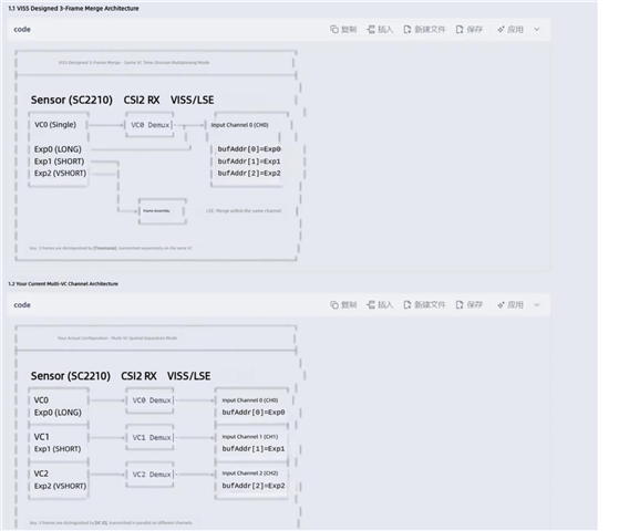

    If the SDK doesn't support it natively, could we implement a node to rearrange the pointers—mapping exp0_ch_0/1/2 to exp0_ch_0, exp1_ch_0, and exp2_ch_0—so that the VISS merge can handle it?
  • Here are the details on how to acquire exposure frames. Please review Configuration 1 and Configuration 2.
  • Is the block diagram in 1.1 supported by your native architecture? The diagram in 1.2 represents the current issue that needs to be resolved. Can we handle this by adding a new node to reorganize the data before feeding it into the VISS?
  • Reorganize the first frame data from the three channels (originally exp0_ch_0, exp0_ch_1, exp0_ch_2) to target the same channel index across different exposures (i.e., exp0_ch_0, exp1_ch_0, exp2_ch_0).
    Input (capture output):
    [exp0_ch_0_cam0, exp1_ch_0_cam0, exp2_ch_1_cam0, exp0_ch_1_cam1, exp1_ch_1_cam1, exp2_ch_1_cam1, exp0_ch_2_cam2, exp1_ch_2_cam2, exp2_ch_2_cam2]
    Map the sequence [exp0_ch_0_cam0, exp0_ch_1_cam1, exp0_ch_2_cam2] to the output [exp0_ch_0_cam0, exp1_ch_0_cam1, exp2_ch_0_cam0] (HDR fusion expectation).

  • Hello,
    So CSIRX will store all three channels in object array? But when we connect this to VISS, VISS node will process only first channel. If we replicate VISS node, each channel will be separately processed.
  • When you mention "three channels," do you mean exp0, exp1, exp2 or ch0, ch1, ch2?
    My understanding is that ch0 contains exp0, exp1, and exp2. If by "channel" you refer to ch0, can VISS process all three exposures (exp0, exp1, exp2) within it, or is it limited to processing only exp0?
  • Hello,
    But that's what i am asking. How are these exposures captured by CSIRX? Are you creating an object array to store these three exposures and treating them as channels? Because in OpenVX, object array contains different channel's data.
  • Yes, we use a vx_object_array to encapsulate the three exposures as separate raw_image objects, forming a multi-channel-like data structure.
  • Hello,
    That means you treating exposures as channels, isn't it? VISS node currently do not support extracting exposures from object array..
  • So, how does VISS currently support triple exposure? Or how can triple exposure be fed into VISS?
  • Hello,
    Unfortunately we have not validated/supported merge in the VISS node. VISS node supports raw_image data structure as input and this data structure does support multiple exposure pointers..
