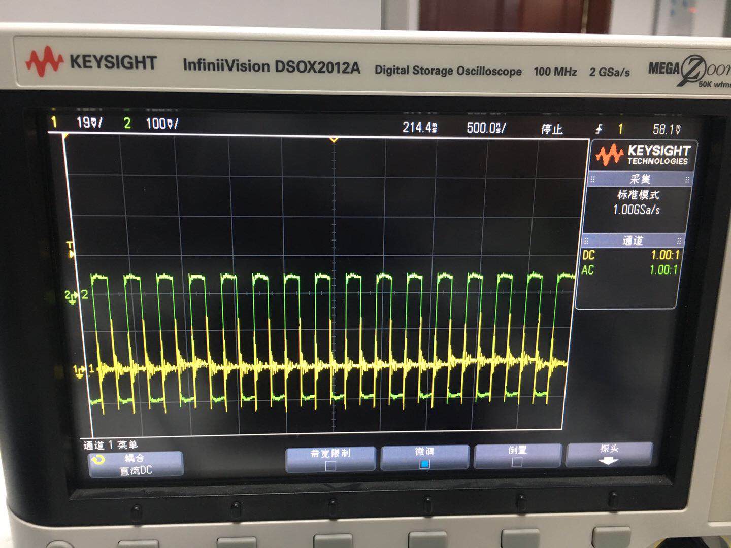

c437x进行spi通信,但是dout输出一直都是0,示波器的波形显示也不太正常
Other Parts Discussed in Thread: ADC128S022
示波器显示的信号如下所示。设备树种配置也如下,请问shi
设备树中配置如下:
<spi0_pins_default: spi0_pins_default {
                        0x150 ( PIN_INPUT | MUX_MODE0 ) /* (P23) spi0_sclk.spi0_sclk */
                        0x158 ( PIN_INPUT  | MUX_MODE0 ) /* (T21) spi0_d1.spi0_d1 */
spi部分设置如下:
<&spi0 {
        status = "okay";
        pinctrl-names = "default";
        pinctrl-0 = <&spi0_pins_default>;
        pinctrl-1 = <&spi0_pins_sleep>;
        ti,pindir-d0-in-d1-out =<1>; // optional
        cs0-gpio = <&gpio0 5 GPIO_ACTIVE_LOW>;                /* Bank 0 pin 5 软件控制cs片选*/
        /*spidev@0{   /* 将此块注释掉,然后使用的是自己编写的驱动程序 */
                status = "okay";
                compatible = "rohm,dh2228fv";
                spi-max-frequency = <48000000>;
                reg =<0x0>;
        adc128@0{
                status = "okay";
                compatible = "ti,adc128s022-0";
                spi-max-frequency = <3200000>;
                reg = <0>;
