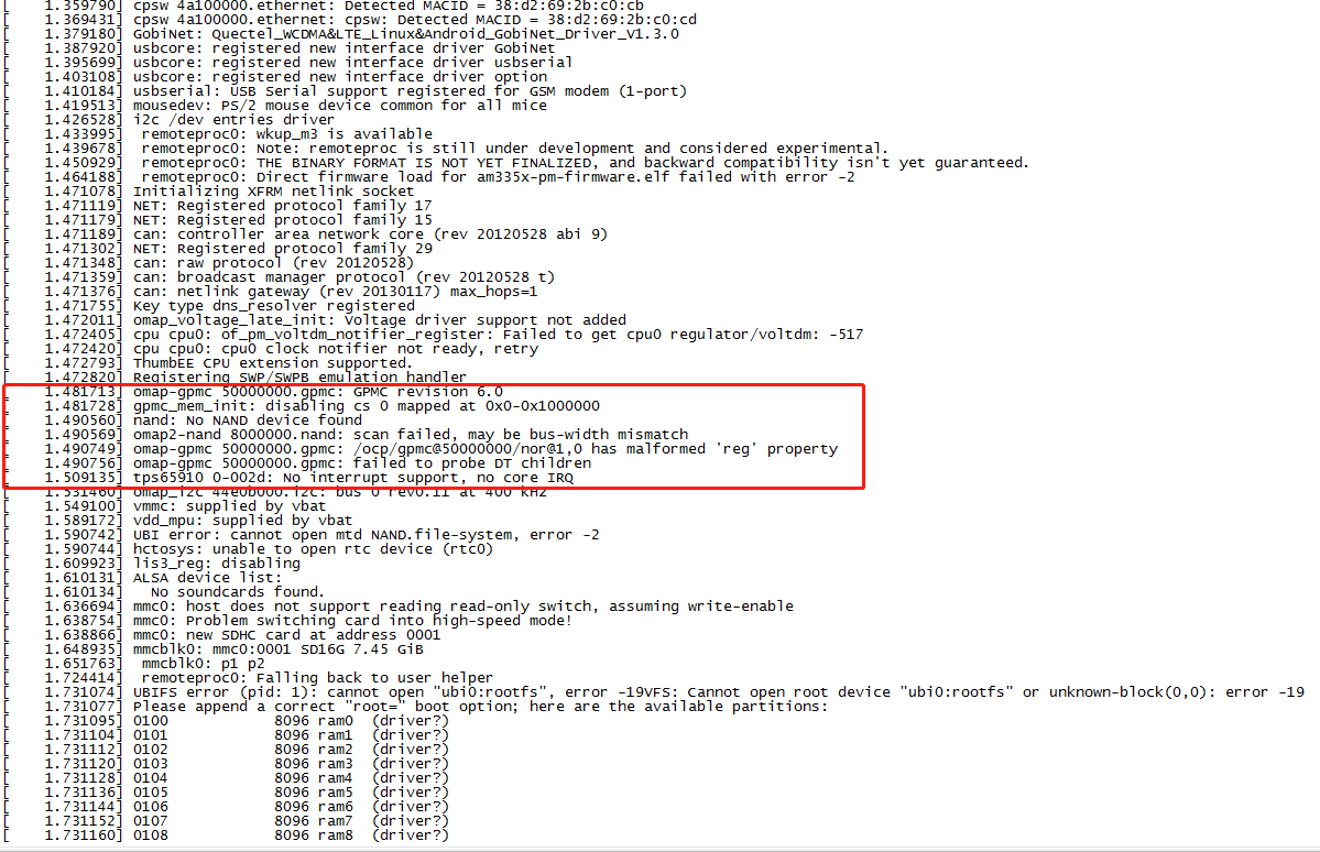

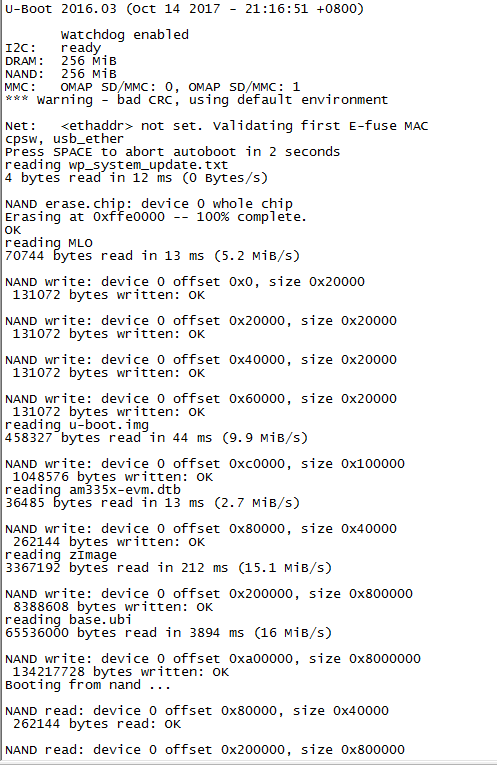

am335x uboot可以正常的从sd卡中拷贝到nand,但是kernel却无法看到nand设备
uboot阶段可以正常的对nand进行擦除和读写,如下图
启动kernel之后,在kernel阶段却会出现no nand device,如下图
下图是我的设备树引脚配置和gpmc相关的nand配置

  • 我从tftp启动内核,发现问题并不是nand,我把错误信息贴出来,这里已经把nand相关的节点都注释掉了

    [    1.590779]  r10:00000000 r9:00000000 r8:cf02c800 r7:00000000 r6:00000000 r5:cf402600
    [    1.590782]  r4:cf402608
    [    1.590793] [<c02bad44>] (kobject_uevent) from [<c03d4d60>] (device_add+0x3b4/0x568)
    [    1.590800] [<c03d49ac>] (device_add) from [<c03d50b0>] (device_create_groups_vargs+0xa8/0xc4)
    [    1.590810]  r10:00000000 r9:00a0003a r8:00000000 r7:c08dc0ec r6:cf402608 r5:cf402600
    [    1.590813]  r4:00000000
    [    1.590821] [<c03d5008>] (device_create_groups_vargs) from [<c03d5154>] (device_create_with_groups+0x28/0x30)
    [    1.590830]  r9:c089c418 r8:c08ee000 r7:c0921c4c r6:c0921180 r5:c08dc0f8 r4:00000000
    [    1.590854] [<c03d512c>] (device_create_with_groups) from [<c038cdf8>] (misc_register+0xc0/0x134)
    [    1.590857]  r4:c08dc0ec
    [    1.590869] [<c038cd38>] (misc_register) from [<c088cd78>] (ubi_init+0x94/0x2a8)
    [    1.590875]  r6:c08a202c r5:c0921c4c r4:00000000
    [    1.590886] [<c088cce4>] (ubi_init) from [<c0009684>] (do_one_initcall+0x88/0x1e0)
    [    1.590896]  r9:c089c418 r8:c08ee000 r7:cf403dc0 r6:c08ae8a0 r5:c088cce4 r4:c08ae8a0
    [    1.590906] [<c00095fc>] (do_one_initcall) from [<c0866e08>] (kernel_init_freeable+0xfc/0x1c0)
    [    1.590916]  r10:c08665e8 r9:c089c418 r8:c08ee000 r7:c08a813c r6:c08ee000 r5:c089c414
    [    1.590919]  r4:00000007
    [    1.590935] [<c0866d0c>] (kernel_init_freeable) from [<c0625d74>] (kernel_init+0x10/0xf4)
    [    1.590944]  r10:00000000 r9:00000000 r8:00000000 r7:00000000 r6:00000000 r5:c0625d64
    [    1.590947]  r4:00000000
    [    1.590961] [<c0625d64>] (kernel_init) from [<c000f8a8>] (ret_from_fork+0x14/0x2c)
    [    1.590966]  r5:c0625d64 r4:00000000
    [    1.590974] Code: eb0a2b5a e5953020 e3530000 0a000003 (e5932000)
    [    1.590986] ---[ end trace 0000000000000002 ]---
    [    1.591058] Kernel panic - not syncing: Attempted to kill init! exitcode=0x0000000b
    [    1.591058]
    [    2.392839] ---[ end Kernel panic - not syncing: Attempted to kill init! exitcode=0x0000000b
    [    2.392839]
    [    2.393038] Unable to handle kernel paging request at virtual address e3a03029
    [    2.393042] pgd = c0004000
    [    2.393046] [e3a03029] *pgd=00000000
    [    2.393051] Internal error: Oops: 5 [#2] PREEMPT ARM
    [    2.393056] Modules linked in:
    [    2.393067] CPU: 0 PID: 7 Comm: rcu_preempt Tainted: G      D         4.1.18-rt17-g4415f52 #3
    [    2.393070] Hardware name: Generic AM33XX (Flattened Device Tree)
    [    2.393073] task: cf04e100 ti: cf06c000 task.ti: cf06c000
    [    2.393095] PC is at __note_gp_changes+0x88/0xd0
    [    2.393100] LR is at __note_gp_changes+0xa8/0xd0
    [    2.393105] pc : [<c006ebfc>]    lr : [<c006ec1c>]    psr: 00000193
    [    2.393105] sp : cf06df20  ip : 00000001  fp : cf06df34
    [    2.393108] r10: cf06c000  r9 : c08ac134  r8 : c08eb519
    [    2.393112] r7 : c08b954c  r6 : c08b9bd0  r5 : c08b9490  r4 : c08b997c
    [    2.393115] r3 : 00000000  r2 : e3a03001  r1 : 00000001  r0 : 00000000
    [    2.393120] Flags: nzcv  IRQs off  FIQs on  Mode SVC_32  ISA ARM  Segment kernel
    [    2.393124] Control: 10c5387d  Table: 80004019  DAC: 00000015
    [    2.393127] Process rcu_preempt (pid: 7, stack limit = 0xcf06c210)
    [    2.393131] Stack: (0xcf06df20 to 0xcf06e000)
    [    2.393139] df20: c08b9490 c08b9490 cf06df64 cf06df38 c006f494 c006eb80 00000000 c08b954c
    [    2.393146] df40: 0006df64 cf04e100 cf06df48 cf06df48 c08b9490 c006efd4 cf06dfac cf06df68
    [    2.393153] df60: c004e774 c006efe0 00000000 00000000 00000000 c08b9490 00000000 cf06df7c
    [    2.393160] df80: cf06df7c 00000000 cf06df88 cf06df88 cf02c040 c004e6a8 00000000 00000000
    [    2.393167] dfa0: 00000000 cf06dfb0 c000f8a8 c004e6b4 00000000 00000000 00000000 00000000
    [    2.393174] dfc0: 00000000 00000000 00000000 00000000 00000000 00000000 00000000 00000000
    [    2.393180] dfe0: 00000000 00000000 00000000 00000000 00000013 00000000 00000000 00000000
    [    2.393183] Backtrace:
    [    2.393197] [<c006eb74>] (__note_gp_changes) from [<c006f494>] (rcu_gp_kthread+0x4c0/0xac8)
    [    2.393203]  r5:c08b9490 r4:c08b9490
    [    2.393214] [<c006efd4>] (rcu_gp_kthread) from [<c004e774>] (kthread+0xcc/0xe4)
    [    2.393217]  r7:c006efd4
    [    2.393227] [<c004e6a8>] (kthread) from [<c000f8a8>] (ret_from_fork+0x14/0x2c)
    [    2.393233]  r7:00000000 r6:00000000 r5:c004e6a8 r4:cf02c040
    [    2.393239] Code: 13a01001 01a01003 e5843018 e5c4100d (e5922028)
    i01 01a01003 e5843018 e5c4100d (e5922028)
    [    2.662195] ---[ end trace 0000000000000003 ]---
    [    2.662202] note: rcu_preempt[7] exited with preempt_count 1
    [    2.683966]  remoteproc0: Falling back to user helper
  • 设备树里有定义rtc吗?有的话,请把rtc remove掉试试。
  • rtc我注释掉了,还是没有什么改善
    每次错误的指针都是定位在PC is at __note_gp_changes+0x88/0xd0
  • 请问您的问题解决了没?没有的话,我去问问e2e。
