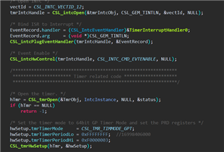

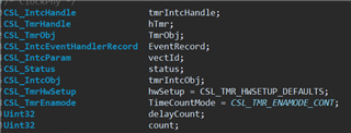

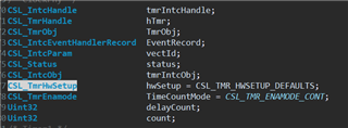

    64bit 配置是timer_test.c 中包含的test_gp_timer   用的是TIMR0     配置如下
    Int32 test_gp_timer (Uint8 IntcInstance)
    /* Clear local data structures */
    memset(&TmrObj, 0, sizeof(CSL_TmrObj));
    // printf("Debug: Testing 64bit Timer in Single Shot Mode...\n");
    ********************** INTC related code *********************
    /* Open INTC */
    vectId = CSL_INTC_VECTID_12;
    tmrIntcHandle = CSL_intcOpen(&tmrIntcObj, CSL_GEM_TINTLN, &vectId, NULL);
    /* Bind ISR to Interrupt */
    EventRecord.handler = (CSL_IntcEventHandler)&TimerInterruptHandler0;
    EventRecord.arg = (void *)CSL_GEM_TINTLN;
    CSL_intcPlugEventHandler(tmrIntcHandle, &EventRecord);
    /* Event Enable */
    CSL_intcHwControl(tmrIntcHandle, CSL_INTC_CMD_EVTENABLE, NULL);
    ********************** Timer related code ********************
    /* Open the timer. */
    hTmr = CSL_tmrOpen(&TmrObj, IntcInstance, NULL, &status);
    if (hTmr == NULL)
    return -1;
    /* Set the timer mode to 64bit GP Timer Mode and set the PRD registers */
    hwSetup.tmrTimerMode = CSL_TMR_TIMMODE_GPT;
    hwSetup.tmrTimerPeriodLo = 0xFFFFFFFF; //16998406000
    hwSetup.tmrTimerPeriodHi = 0xF0000003;
    CSL_tmrHwSetup(hTmr, &hwSetup);
    /* Reset the timer ISR Counter. */
    timerISRCounter0 = 0;
    /* Reset the Timer */
    CSL_tmrHwControl(hTmr, CSL_TMR_CMD_RESET64, NULL);
    /* Start the timer in SINGLE SHOT Mode. */
    CSL_tmrHwControl(hTmr, CSL_TMR_CMD_START64, (void *)&TimeCountMode);
    return 0;

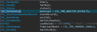

    32bit用的是TIMER2  默认配置的来  具体如下
    Int32 test_32bit_timer (Uint32 *LoadValue) {
    ********************** 初始化Timer1 *********************
    memset(&TmrObj1, 0, sizeof(CSL_TmrObj));
    /* Open INTC */
    vectId1 = CSL_INTC_VECTID_5;
    tmrIntcHandle1 = CSL_intcOpen(&tmrIntcObj1, CSL_GEM_TINT2L, &vectId1, NULL);
    EventRecord1.handler = (CSL_IntcEventHandler)&TimerInterruptHandler1;
    EventRecord1.arg = (void *)CSL_GEM_TINT2L;
    CSL_intcPlugEventHandler(tmrIntcHandle1, &EventRecord1);
    /* Event Enable */
    CSL_intcHwControl(tmrIntcHandle1, CSL_INTC_CMD_EVTENABLE, NULL);
    hTmr1 = CSL_tmrOpen(&TmrObj1, CSL_TMR_2, NULL, &status1);
    /* Open the timer with the defaults. */
    CSL_tmrHwSetup(hTmr1, &hwSetup1);
    /* Stop the Timer */
    CSL_tmrHwControl(hTmr1, CSL_TMR_CMD_RESET_TIMLO, NULL);
    /* Set the timer mode to unchained dual mode */
    hwSetup1.tmrTimerMode = CSL_TMR_TIMMODE_DUAL_UNCHAINED;
    timerISRCounter1 = 0;
    /* Load the period register */
    status1 = CSL_tmrHwControl(hTmr1, CSL_TMR_CMD_LOAD_PRDLO, (void *)LoadValue);
    CSL_tmrHwControl(hTmr1, CSL_TMR_CMD_START_TIMLO, (void *)&TimeCountMode1);
    return 0;
