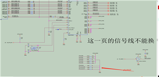

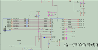

AM5728: AM5728参考的IDK设计,但是启动后找不到phy地址
Part Number: AM5728
Other Parts Discussed in Thread: DRA752
你好,
我们参考了5728 idk的设计,原理图设计的phy地址是0,但是使用idk的配置启动文件,找不到phy? 请帮忙看看是什么问题呢,谢谢。
[ 7.232331] FAT-fs (mmcblk0p1): Volume was not properly unmounted. Some data may be corrupt. Please run fsck.
[ 7.287222] net eth1: initializing cpsw version 1.15 (0)
[ 7.287229] cpsw 48484000.ethernet: initialized cpsw ale version 1.4
[ 7.287233] cpsw 48484000.ethernet: ALE Table size 1024
[ 7.328762] libphy: PHY 48485000.mdio:01 not found
[ 7.328770] net eth1: phy "48485000.mdio:01" not found on slave 1, err -19
[ 7.343777] cpts ptp bc clkid 0
[ ! 7.381524] IPv6: ADDRCONF(NETDEV_UP): eth1: link is not ready
[ 7.384610] net eth0: initializing cpsw version 1.15 (0)
[ 7.436152] libphy: PHY 48485000.mdio:00 not found
[ 7.436171] net eth0: phy "48485000.mdio:00" not found on slave 0, err -19
[ 7.454142] IPv6: ADDRCONF(NETDEV_UP): eth0: link is not ready
[ OK ] Started Network Service.
下面是完整的启动log
