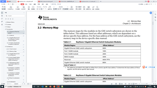

Part Number: TMS320C6678
For the base address of the GbE switch subsystem, see the memory map in the device-specific data manual
文档中描述的地址均为偏移地址,其中提到查看基地址需要去看 device-specific data manual ,这个单独的数据手册在哪里呢
数据手册是指datasheet。
Table 2-2 Memory Map Summary (Sheet 2 of 7)
Network Coprocessor (Packet Accelerator, Gigabit Ethernet Switch Subsystem and Security Accelerator
https://www.ti.com/lit/ds/symlink/tms320c6678.pdf
