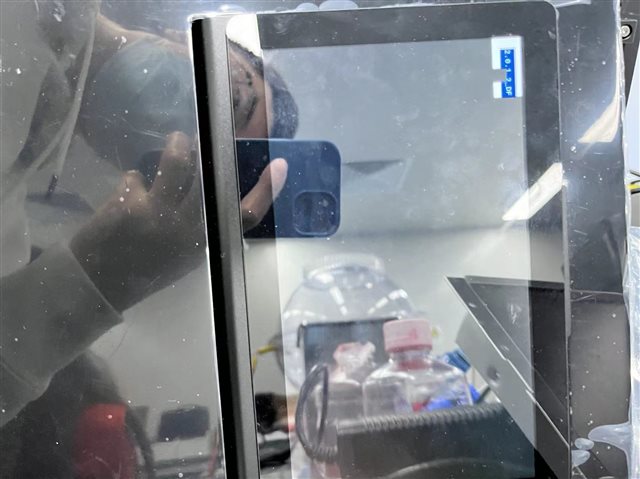

HI

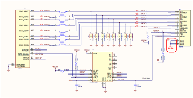

  采用控制器AM5728,接入HDMI接口,连接屏幕,屏幕只显示如图所示,电路图如图所示,通过串口查看SGX544一直处于初始化状态直到失败。请问是哪里出了问题,请帮忙分析解答下。谢谢

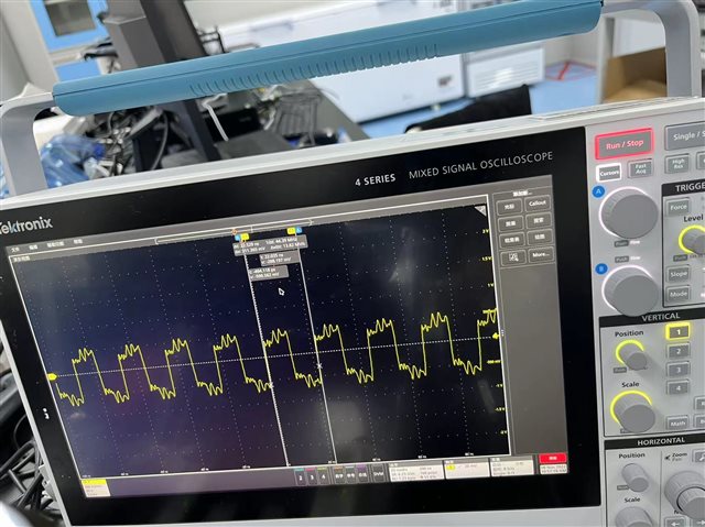

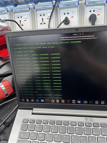

  • 通过查看串口显示SGX初始化失败,如图所示,测试的HDMI信号波形补上,电感前后波形看不出区别,

  • 谢谢您的回复,屏幕可以正常显示文本没有问题,但是显示图片就会出错,出错如下,请帮忙分析下原因,是哪里出了问题呢?
    am57xx-evm login: [   34.327750] omap_l3_noc 44000000.ocp: L3
    application error: target 5 mod:1 (unclearable)
    [   34.335907] omap_l3_noc 44000000.ocp: L3 debug error: target 5 mod:1
    (unclearable)
    [   34.540907] PVR_K:(Error): SGXOSTimer() detected SGX lockup (0x2d03
    tasks)
    [   34.547822] PVR_K: HWRecoveryResetSGX: SGX Hardware Recovery
    triggered
    [   34.554838] PVR_K: SGX debug (SGX_DDK_Linux_XOrg sgxddk
    1.17@4948957)
    [   34.561516] PVR_K:(Error): SGX Register Base Address (Linear):
    0x02134669
    [   34.568515] PVR_K:(Error): SGX Register Base Address (Physical):
    0x56000000
    [   34.575950] PVR_K: Running SGXREG Debug Scripts:
    [   34.580594] PVR_K: (HYD)
    [   34.583147] PVR_K:         (SGXREG) 0x00004000 : 0x00000001
    [   34.588149] PVR_K:         (SGXREG) 0x00004004 : 0x0000000A
    [   34.593144] PVR_K:         (SGXREG) 0x00004008 : 0x0000000F
    [   34.598136] PVR_K:         (SGXREG) 0x00004024 : 0x00000005
    [   34.603130] PVR_K:         (SGXREG) 0x00004118 : 0x00000008
    [   34.608122] PVR_K:         (SGXREG) 0x0000412C : 0x20000000
    [   34.613116] PVR_K:         (SGXREG) 0x00004404 : 0x00000000
    [   34.618109] PVR_K:         (SGXREG) 0x00004C04 : 0x00080000
    [   34.623102] PVR_K:         (SGXREG) 0x00004C08 : 0x00000000
    [   34.628095] PVR_K:         (SGXREG) 0x00004C74 : 0x00000000
    [   34.633089] PVR_K:         (SGXREG) 0x00004C78 : 0x00000000
    [   34.638080] PVR_K:         (SGXREG) 0x00004CA8 : 0x00000008
    [   34.643073] PVR_K: (P0)
    [   34.645535] PVR_K:         (SGXREG) 0x00008000 : 0x002AAAAA
    [   34.650526] PVR_K:         (SGXREG) 0x00008004 : 0x0A8A8AAA
    [   34.655520] PVR_K:         (SGXREG) 0x00008008 : 0x0103BB87
    [   34.660512] PVR_K:         (SGXREG) 0x00008118 : 0x000000A8
    [   34.665504] PVR_K:         (SGXREG) 0x0000812C : 0x24142600
    [   34.670496] PVR_K:         (SGXREG) 0x000084E4 : 0x00000008
    [   34.675489] PVR_K:         (SGXREG) 0x00008658 : 0x00000000
    [   34.680481] PVR_K:         (SGXREG) 0x00008A74 : 0x0E208200
    [   34.685511] PVR_K:         (SGXREG) 0x00008BA4 : 0x00000001
    [   34.690503] PVR_K:         (SGXREG) 0x00008C04 : 0x00080000
    [   34.695497] PVR_K:         (SGXREG) 0x00008C08 : 0x00000000
    [   34.700488] PVR_K:         (SGXREG) 0x00008C74 : 0x00000000

  • 在没有 HDMI 显示器(也就是任何其他显示器)的情况下,请问是否会出现问题?
    请您注意,我们不再支持 SGX GPU 驱动程序问题。但是请让我们查看这个问题是否 由GPU 驱动程序引起,或者驱动程序故障是否是另一个问题的表现。
  • 在没有 HDMI 显示器(也就是任何其他显示器)的情况下,没有出问题;采用串口检测程序没有加在到图像显示情况下,不出问题,如果接上屏幕显示显示文本也没有问题,但是显示图形就会出问题

  • 看到您分享了一个电路图。这是定制板(custom board)吗?还是 TI EVM?
  • 自己绘制的板卡,是猜测走线有问题吗?请问一般哪里的线会导致这种现象产生呢
  • 我已要求我们的 HW 团队迅速查验您共享的原理图。

    您能分享完整的boot log和失败log吗?
