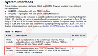

rgmii mode
root@j7-evm:~# devmem2 0x104050
/dev/mem opened.
Memory mapped at address 0xffffa1c10000.
Read at address 0x00104050 (0xffffa1c14050): 0x00000012
root@j7-evm:~#

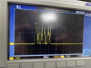

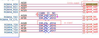

pc 与平台同网段,无法ping通
请问一下,应该如何调试此问题

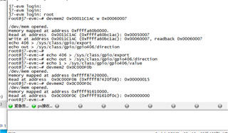

  • This might be very basic, but can you confirm if you are rebuilding the ethfw binary and replacing it in the linux kernel?
    这个需要怎样做啊?
    Can you check if there is any difference in the following registers between SDK 7.3 and SDK 8.4
    • 0x0C000F08
    • 0x0C000F0C
    后面回复你
    Which MAC port is the phy attached to?
    mac 4
    Which phy are you using?
    88Q2112
    这个需要怎样做啊
    cp ./ethfw/out/J721E/R5Ft/FREERTOS/release/app_remoteswitchcfg_server_strip.xer5f /lib/firmware/ethfw/app_remoteswitchcfg_server_strip.xer5f  ?
  • root@j7-evm:~# devmem2 0x0C000F0b
    /dev/mem opened.
    Memory mapped at address 0xffff80b5d000.
    Read at address 0x0C000F0B (0xffff80b5df08): 0x00000004
    root@j7-evm:~# devmem2 0x0C000F0c
    /dev/mem opened.
    Memory mapped at address 0xffff820fc000.
    Read at address 0x0C000F0C (0xffff820fcf0c): 0x00000000
    root@j7-evm:~#
  • [MCU2_0] 149500.296863 s: Cpsw_handleLinkUp: Port 4: Link up: 1-Gbps Full-Duplex

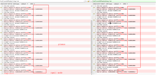

  • Can you provide me the values at these addresses along with the registers mentioned in the earlier post:
    • 0x0C00003C
    • 0x0C025330
    • 0x0C025334
    • 0x00104050
    root@j7-evm:~# devmem2 0x0C00003C
    /dev/mem opened.
    Memory mapped at address 0xffffa1be5000.
    Read at address 0x0C00003C (0xffffa1be503c): 0x0000000D
    root@j7-evm:~# devmem2 0x0C025330
    /dev/mem opened.
    Memory mapped at address 0xffff9697a000.
    Read at address 0x0C025330 (0xffff9697a330): 0x000200A1
    root@j7-evm:~# devmem2 0x0C025334
    /dev/mem opened.
    Memory mapped at address 0xffffbb71a000.
    Read at address 0x0C025334 (0xffffbb71a334): 0xF0000018
    root@j7-evm:~# devmem2 0x00104050
    /dev/mem opened.
    Memory mapped at address 0xffffbf2d5000.
    Read at address 0x00104050 (0xffffbf2d5050): 0x00000012
    root@j7-evm:~#

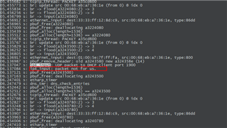

    Can you also provide the ethfw log on MAIN UART 2. If you do not have MAIN UART 2 on your board, give me the out put of the command "cat /sys/kernel/debug/remoteproc/remoteproc*/trace0
    root@j7-evm:~# cat /sys/kernel/debug/remoteproc/remoteproc*/trace*
    Sciclient_boardCfgRm init Passed
    DM Built On: Jun 16 2022 04:16:33
    Sciserver Version: v2022.01.1.0-REL.CORESDK.08.02.01.03-1-g59713
    RM_PM_HAL Version: REL.CORESDK.08.02.01.03-1-g59713
    Starting Sciserver..... PASSED
    IPC_echo_test (core : mcu1_0) .....

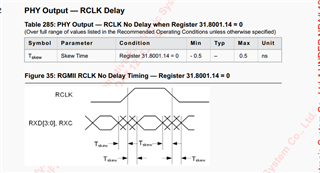

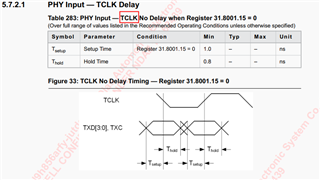

  • Also can you provide what are the internal delays configured in the phy?
  • 已把您的回复更新到e2e帖子,请关注帖子的回复。
  • Is this the complete output? If it is, then your remote cores are not running any binaries. So no ethfw is running. Have you changed both Linux and RTOS SDK to 8.4? or is one still earlier version?
    这个是从sdcard启动
  • 能否回答上面工程师的问题?
    是的,但是我另外一款phy,100M,挂在mac 3上rmii3上,可以 获取Ip,现在我是单独调试1000M mac4/rgmii4
  • Have you changed both Linux and RTOS SDK to 8.4? or is one still earlier version?是的,我现在用的都是8.4sdk里的img
  • 请看e2e工程师的最新回复。
    It boots from sd card.
    By this I am assuming that it boots from the default SD card from 8.4. Respond if this is incorrect.
    You can turn the tx and rx delays on and off in the phy using bootstraps in the hardware design. This is the usual practice. Please let me know what are they configured as. There will also be some phy register which has this information.
    Please provide response on this.
  • 我看7.3中类似的代码是这样
    void Dp83867_initCfg(Dp83867_Cfg *cfg)
    cfg->txClkShiftEn = false;
    cfg->rxClkShiftEn = false;
    cfg->txDelayInPs = 2000U; /* 2.00 ns */
    cfg->rxDelayInPs = 2000U; /* 2.00 ns */
    cfg->txFifoDepth = 4U; /* 4 bytes/nibbles */
    cfg->impedanceInMilliOhms = 50000U; /* 50 ohms */
    cfg->gpio0Mode = DP83867_GPIO0_RXERR;
    cfg->gpio1Mode = DP83867_GPIO1_COL;
    cfg->ledMode[0] = DP83867_LED_LINKED;
    cfg->ledMode[1] = DP83867_LED_LINKED_1000BT;
    cfg->ledMode[2] = DP83867_LED_RXTXACT;
    cfg->ledMode[3] = DP83867_LED_LINKED_100BTX;
    这应该是型号Dp83867的code,但相应的88Q2112并没有去控制rgmii tx shift 在7.3中
  • 图片显示不出来,请回复时点击"插入"图片。
  • By this I am assuming that it boots from the default SD card from 8.4. Respond if this is incorrect.
    还有这个问题,麻烦回答一下。
  • 7.3中phy默认是align,即phy处于no delay的情况
    还有这个问题,麻烦回答一下。
    麻烦回答一下这个问题,是否默认是从8.4 sd卡启动的?
  • 是的,现在我用8.4,sdcard启动(bootmode 拨码默认从sdcard启动)
  • root@j7-evm:~# /opt/vision_apps/vision_apps_init.sh
    root@j7-evm:~# [MCU2_0] 158.950501 s: CIO: Init ... Done !!!
    [MCU2_0] 158.950578 s: ### CPU Frequency = 1000000000 Hz
    [MCU2_0] 158.950637 s: APP: Init ... !!!
    [MCU2_0] 158.950669 s: SCICLIENT: Init ... !!!
    [MCU2_0] 158.951648 s: SCICLIENT: DMSC FW version [21.1.1--v2021.01a (Terrific Lla]
    [MCU2_0] 158.951702 s: SCICLIENT: DMSC FW revision 0x15
    [MCU2_0] 158.951741 s: SCICLIENT: DMSC FW ABI revision 3.1
    [MCU2_0] 158.951779 s: SCICLIENT: Init ... Done !!!
    [MCU2_0] 158.951807 s: UDMA: Init ... !!!
    [MCU2_0] 158.961043 s: UDMA: Init ... Done !!!
    [MCU2_0] 158.961109 s: MEM: Init ... !!!
    [MCU2_0] 158.961156 s: MEM: Created heap (DDR_LOCAL_MEM, id=0, flags=0x00000004) @ d9000000 of size 16777216 bytes !!!
    [MCU2_0] 158.961236 s: MEM: Created heap (L3_MEM, id=1, flags=0x00000000) @ 3600000 of size 262144 bytes !!!
    [MCU2_0] 158.961301 s: MEM: Init ... Done !!!
    [MCU2_0] 158.961329 s: IPC: Init ... !!!
    [MCU2_0] 158.961394 s: IPC: 6 CPUs participating in IPC !!!
    [MCU2_0] 158.961466 s: IPC: Waiting for HLOS to be ready ... !!!
    [MCU2_0] 163.436719 s: IPC: HLOS is ready !!!
    [MCU2_0] 163.456965 s: IPC: Init ... Done !!!
    [MCU2_0] 163.457037 s: APP: Syncing with 5 CPUs ... !!!
    [MCU2_0] 163.494209 s: APP: Syncing with 5 CPUs ... Done !!!
    [MCU2_0] 163.494570 s: REMOTE_SERVICE: Init ... !!!
    [MCU2_0] 163.496578 s: REMOTE_SERVICE: Init ... Done !!!
    [MCU2_0] 163.496652 s: ETHFW: Init ... !!!
    [MCU2_0] 163.517888 s: ETHFW: appEthFwTimmingInit start... !!!
    [MCU2_0] 163.517951 s: ETHFW: appEthFwTimmingInit exit... !!!
    [MCU2_0] 163.518017 s: Warning: Using 6 MAC address(es) from static pool
    [MCU2_0] 163.518106 s: ETHFW: Shared multicasts (software fanout):
    [MCU2_0] 163.518149 s: 01:00:5e:00:00:01
    [MCU2_0] 163.518203 s: 01:00:5e:00:00:fb
    [MCU2_0] 163.518251 s: 01:00:5e:00:00:fc
    [MCU2_0] 163.518299 s: 33:33:00:00:00:01
    [MCU2_0] 163.518346 s: 33:33:ff:1d:92:c2
    [MCU2_0] 163.518394 s: 01:80:c2:00:00:00
    [MCU2_0] 163.518441 s: 01:80:c2:00:00:03
    [MCU2_0] 163.518490 s: ETHFW: Reserved multicasts:
    [MCU2_0] 163.518517 s: 01:80:c2:00:00:0e
    [MCU2_0] 163.518565 s: 01:1b:19:00:00:00
    [MCU2_0] 163.518835 s: EnetMcm: CPSW_9G on MAIN NAVSS
    [MCU2_0] 163.535654 s: PHY 0 is alive

  • 上面是我出问题的日志
  • rgmii 默认模式2
    不能获取ip
    设置成mode1仍然无法获取IP

    我这边打开了8.4dhcp的打印,在win10上创建了一个dhcp server
    --- a/pdk_jacinto_08_04_00_21/packages/ti/transport/lwip/lwip-stack/src/include/lwip/debug.h
    +++ b/pdk_jacinto_08_04_00_21/packages/ti/transport/lwip/lwip-stack/src/include/lwip/debug.h
    @@ -143,14 +143,8 @@
    #ifdef LWIP_DEBUG
    #define LWIP_DEBUGF(debug, message) do { \
    - if ( \
    - ((debug) & LWIP_DBG_ON) && \
    - ((debug) & LWIP_DBG_TYPES_ON) && \
    - ((s16_t)((debug) & LWIP_DBG_MASK_LEVEL) >= LWIP_DBG_MIN_LEVEL)) { \
    + if (1) { \
    LWIP_PLATFORM_DIAG(message); \
    - if ((debug) & LWIP_DBG_HALT) { \
    - while(1); \
    } while(0)
    7.3可以发出dhcp cmd
    8.4打印如下,wireshark没有dhcp cmd(过滤)

    我们在平台上测试了波形,txd0没有量到信号,rxd0量到信号
    日志显示接收到来自phy的数据(mac的rx),目标地址不是平台,应该是来自路由的信号
    对应的port3 phy正常工作,在dhcp时都有波形
