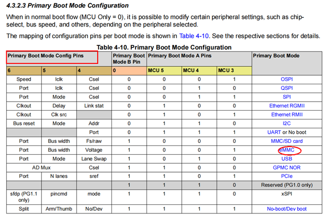

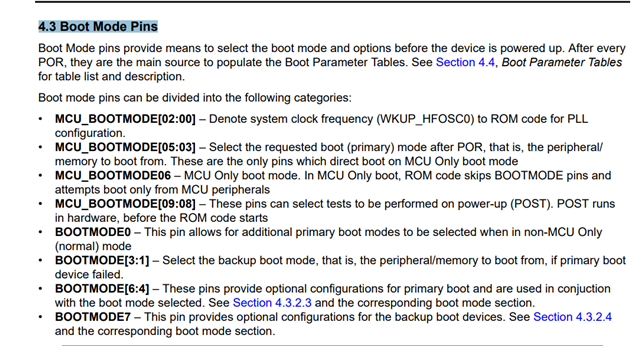

boot from eMMC, I don't know "Primary Boot Mode Config Pins" and "Backup Boot Mode Config Pin "
please describe the meaning and how to configure.

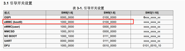

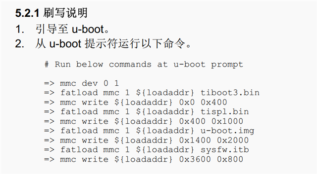

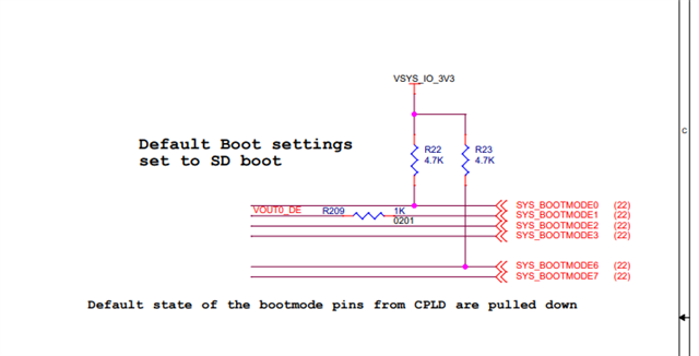

主要是对硬件管脚的配置。
您可以参照开发板上的设计。
https://www.ti.com/lit/ug/spruj21c/spruj21c.pdf
请参考TRM 4.3 Boot Mode Pins.
