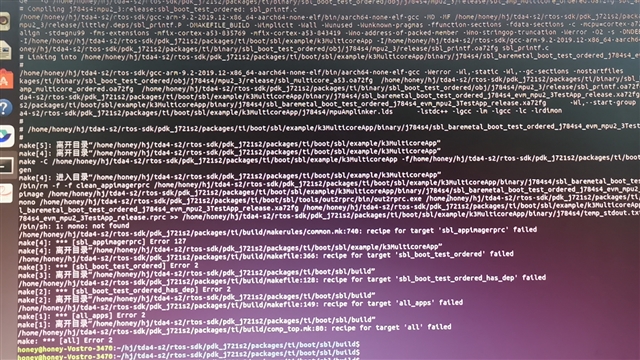

We refer to the above website 5.2.6 to compile SBL, and found that there was an error in making clean all at the very beginning, so I would like to ask what caused it?
Is there any problem with compiling SBL using this URL?
The screenshot of the error is as follows:
目前TDA系列主要通过e2e论坛的产品线工程师提供技术支持。我看到工程师已经回复。
You can see an error here that say "mono not found". You will need to install a library, can you please run:
sudo apt install mono-runtime
