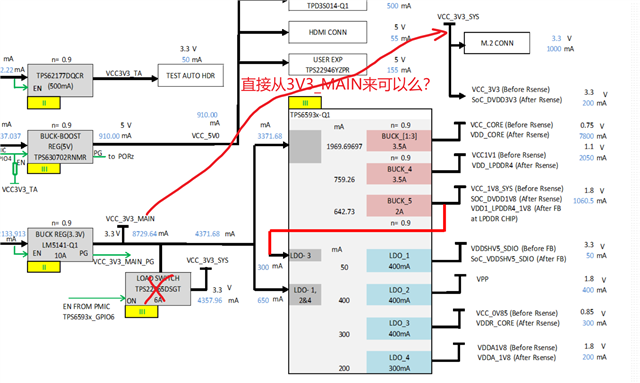

在EVM_sprr459,PROC135E2_SCH 中,3.3V这一路有load SWITCH,请问这颗SWITCH可以去掉么? 作用是什么? 感谢

The load switch is used to switch the main 3.3V to 3.3V_SYS used for the SoC and the attached devices.
The Load switch also performs the voltage sequencing.
With the current architecture this load switch is required for sequencing.
Can you help me understand the use case.
您可以把您的电源设计需求说明一下,让工程师评估一下是否能去掉load switch。
The Load switch control comes from the PMIC and the PMIC sequences the other supply rails used by AM62A.
