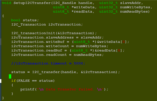

EVM: J721EXCP01EVM
SDK: ti-processor-sdk-rtos-j721e-evm-08_06_01_03
Refer: mcan_evm_loopback_app_main_k3.c
在 J721EXCP01EVM 打算使用
(MCU1_0) MCU MCAN0 – J30 (J29)
(MCU2_1) Main MCAN0 – J27 (J24)
目前設定Main MCAN0時候,IO Expander (TCA6424) 都會發生卡在下列設定。
當使用 I2C_transfer() 無法 return value到 status,程序 hang 在這邊。
想請問是設定TCA6424 時候,周邊沒有搭配好嗎? 或是發生問題!? 謝謝。
void padConfig_prcmEnable() { /* UART Init */ Board_initCfg boardCfg; Board_STATUS boardStatus; I2C_Params i2cParams; I2C_Handle handle = NULL; uint8_t dataToSlave[4]; boardCfg = BOARD_INIT_MODULE_CLOCK | BOARD_INIT_PINMUX_CONFIG; boardStatus = Board_init(boardCfg); if (boardStatus != BOARD_SOK) { App_ConsolePrintf("[Error] Board init failed!!\n"); } #if 0 // No use GESI board. /* Pin mux for CAN STB used in GESI board */ *(volatile unsigned int *)(0x0011c0f4) = 0x20007; /* Pinmux for MAIN_MCAN4 */ *(volatile unsigned int *)(0x0011c020) = 0x60006; *(volatile unsigned int *)(0x0011c024) = 0x60006; /* Pinmux for MAIN_MCAN5 */ *(volatile unsigned int *)(0x0011c04c) = 0x60006; *(volatile unsigned int *)(0x0011c050) = 0x60006; /* Pinmux for MAIN_MCAN6 */ *(volatile unsigned int *)(0x0011c054) = 0x60006; *(volatile unsigned int *)(0x0011c06C) = 0x60006; /* Pinmux for MAIN_MCAN7 */ *(volatile unsigned int *)(0x0011c074) = 0x60006; *(volatile unsigned int *)(0x0011c078) = 0x60006; /* Pinmux for MAIN_MCAN9 */ *(volatile unsigned int *)(0x0011c0cc) = 0x60006; *(volatile unsigned int *)(0x0011c0d0) = 0x60006; /* Pinmux for MAIN_MCAN11 */ *(volatile unsigned int *)(0x0011c11c) = 0x60006; *(volatile unsigned int *)(0x0011c120) = 0x60006; #endif /* J721EXCPEVM - MCU MCAN0 – J30 (J29) - MCU MCAN1 – J31 - Main MCAN0 – J27 (J24) - Main MCAN2 – J28 (J25) */ #if 0 /* GPIO initialization */ GPIO_init(); /* Enable CAN transceivers by setting the STB pins */ /* Enable the TCAN on GESI board. * Main Domain MCAN instances 4,5,6,7,9,11. */ GPIO_write(0, GPIO_PIN_LOW); /* Set MCU_MCAN1_STB to LEVEL_LOW to exit CAN1 from Standby mode */ GPIOSetDirMode_v0(CSL_WKUP_GPIO0_BASE, MCU_MCAN1_STB_PIN, GPIO_DIRECTION_OUTPUT); GPIOPinWrite_v0(CSL_WKUP_GPIO0_BASE, MCU_MCAN1_STB_PIN, GPIO_PIN_LOW); /* Set MCU_MCAN0_EN Enable to LEVEL_HIGH to Enable MCU MCAN 0*/ GPIOSetDirMode_v0(CSL_WKUP_GPIO0_BASE, MCU_MCAN0_ENABLE_PIN, GPIO_DIRECTION_OUTPUT); GPIOPinWrite_v0(CSL_WKUP_GPIO0_BASE, MCU_MCAN0_ENABLE_PIN, GPIO_PIN_HIGH); /* Set MCU_MCAN0_STBz pin to LEVEL_High to exit CAN0 from Standby mode */ GPIOSetDirMode_v0(CSL_WKUP_GPIO0_BASE, MCU_MCAN0_STBZ_PIN, GPIO_DIRECTION_OUTPUT); GPIOPinWrite_v0(CSL_WKUP_GPIO0_BASE, MCU_MCAN0_STBZ_PIN, GPIO_PIN_HIGH); /* Enable Main MCAN 2, GPIO0_127. */ GPIO_write(1, GPIO_PIN_LOW); #endif /* * Configuring TCA6424 IO Exp 2 with addr 0x22 * This io expander is controlled by i2c0 * For Main MCAN2 P13 and P14 should be set to 0, This should route the MCAN2 STB line to transciver. * For Main MCAN0 P06 and P07 should be set to 1. */ /* I2C initialization */ I2C_init(); I2C_Params_init(&i2cParams); i2cParams.transferMode = I2C_MODE_BLOCKING; i2cParams.bitRate = I2C_400kHz; i2cParams.transferCallbackFxn = NULL; handle = I2C_open(0U, &i2cParams); dataToSlave[0] = TCA6424_REG_CONFIG0 | TCA6424_CMD_AUTO_INC; // 0x0CU | 0x80U dataToSlave[1] = 0x0U; SetupI2CTransfer(handle, 0x22, &dataToSlave[0], 2, NULL, 0); dataToSlave[0] = TCA6424_REG_INPUT0 | TCA6424_CMD_AUTO_INC; // 0x00U | 0x80U dataToSlave[1] = 0x0U; dataToSlave[2] = 0x0U; dataToSlave[3] = 0x0U; SetupI2CTransfer(handle, 0x22, &dataToSlave[0], 1, &dataToSlave[1], 3); /* Set P06 and P07 to 1. P06: MCAN0_EN, MCAN0 PHY Enable, Active High ('0' - device disabled, '1' normal operation) P07: MCAN0_STB#, MCAN0 PHY Standby, Active Low ('0' - device standby, '1' - normal operation) * Set P13 and P14 to 0. P13: MLB_MUX_SEL, Signal Mux Control ('0' - MCAN2/Expansion, '1' - 3 Wire MLB) P14: MCAN_MUX_SEL, Signal Mux Control ('0' - MCAN2/GPIO, '1' - Expansion/EQEP) */ dataToSlave[0] = TCA6424_REG_OUTPUT0 | TCA6424_CMD_AUTO_INC; // 0x04U | 0x80U dataToSlave[1] |= 0xC0; dataToSlave[2] &= ~(0x18); SetupI2CTransfer(handle, 0x22, &dataToSlave[0], 1, &dataToSlave[1], 3); }
请看下面e2e工程师的回复。
Is any other firmware running on the other cores? It is possible that some other core is configuring the same IO Expanded.
