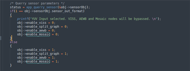

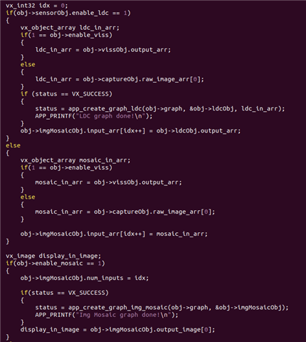

我们使用tda4vh 8.6sdk,使用mosaic节点拼接四路1920*1080的摄像头到3840x2160,在拼接的过程中出现异常如下,如何解决,谢谢

  • 你好,使用的是索尼的摄像头,输入的格式是uyvy,想通过mosaic节点把数据格式转换为nv12后再拼接
  • 能否贴一下您的代码?
  • 你好,代码如下,没有使能ldc和viss,mosaic的输入是capture的输出uvyv格式的视频,mosaic节点可以直接接收uyvy格式的数据然后转换成nv12的数据吗?

        vx_int32 idx = 0;
        if(obj->sensorObj.enable_ldc == 1)
            vx_object_array ldc_in_arr;
            if(1 == obj->enable_viss)
                ldc_in_arr = obj->vissObj.output_arr;
            else
                ldc_in_arr = obj->captureObj.raw_image_arr[0];
            if (status == VX_SUCCESS)
                status = app_create_graph_ldc(obj->graph, &obj->ldcObj, ldc_in_arr, TIVX_TARGET_VPAC_LDC1);
                APP_PRINTF("LDC graph done!\n");
            obj->imgMosaicObj.input_arr[idx++] = obj->ldcObj.output_arr;
        else
            vx_object_array mosaic_in_arr;
                mosaic_in_arr = obj->vissObj.output_arr;
            else
                mosaic_in_arr = obj->captureObj.raw_image_arr[0];
            obj->imgMosaicObj.input_arr[idx++] = mosaic_in_arr;
        vx_image display_in_image;
        if(obj->enable_mosaic == 1)
            obj->imgMosaicObj.num_inputs = idx;
            if(status == VX_SUCCESS)
                status = app_create_graph_img_mosaic(obj->graph, &obj->imgMosaicObj,NULL);
                APP_PRINTF("Img Mosaic graph done!\n");
            display_in_image = obj->imgMosaicObj.output_image[0];
        else
            display_in_image = (vx_image)vxGetObjectArrayItem(obj->captureObj.raw_image_arr[0], 0);
        if((obj->enable_display == 1) && (status == VX_SUCCESS))
            status = app_create_graph_display(obj->graph, &obj->displayObj, display_in_image);

  • 你好,我看到之前的代码如下,mosaic节点是可以直接接收capture的输入的,capture输入的就是uyvy类型的数据
    请问是在哪里看到这个代码的?是TI 例程里的吗?
  • 是TI例程的,比如
    vision_apps/apps/basic_demos/app_multi_cam/main.c
    app_create_graph
  • 请看下面工程师的回复。
    obj->enable_mosaic = 0 for YUV422 format as shown below
    Hence, in this above case, the mosaic node is not created at all.
    It is direct capture to display node.
