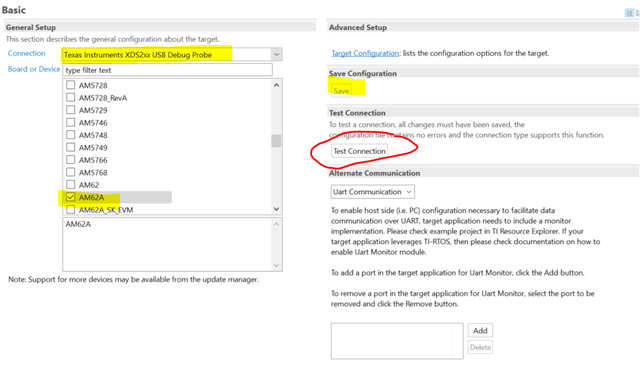

Hi,
I use this debug setup , and click "Test Connection", but failed. The log is as follows:

Do you know the problem? By the way, how to slow down the speed of XDS200?

  • 请问是TI的EVM板还是自己的板子?
  • 自己项目的。
  • 请问是自己的板子是参考EVM板吗?请按照下面的文档检查一下JTAG电路。
    https://software-dl.ti.com/ccs/esd/documents/ccsv7_debugging_jtag_connectivity_issues.html#power-loss
