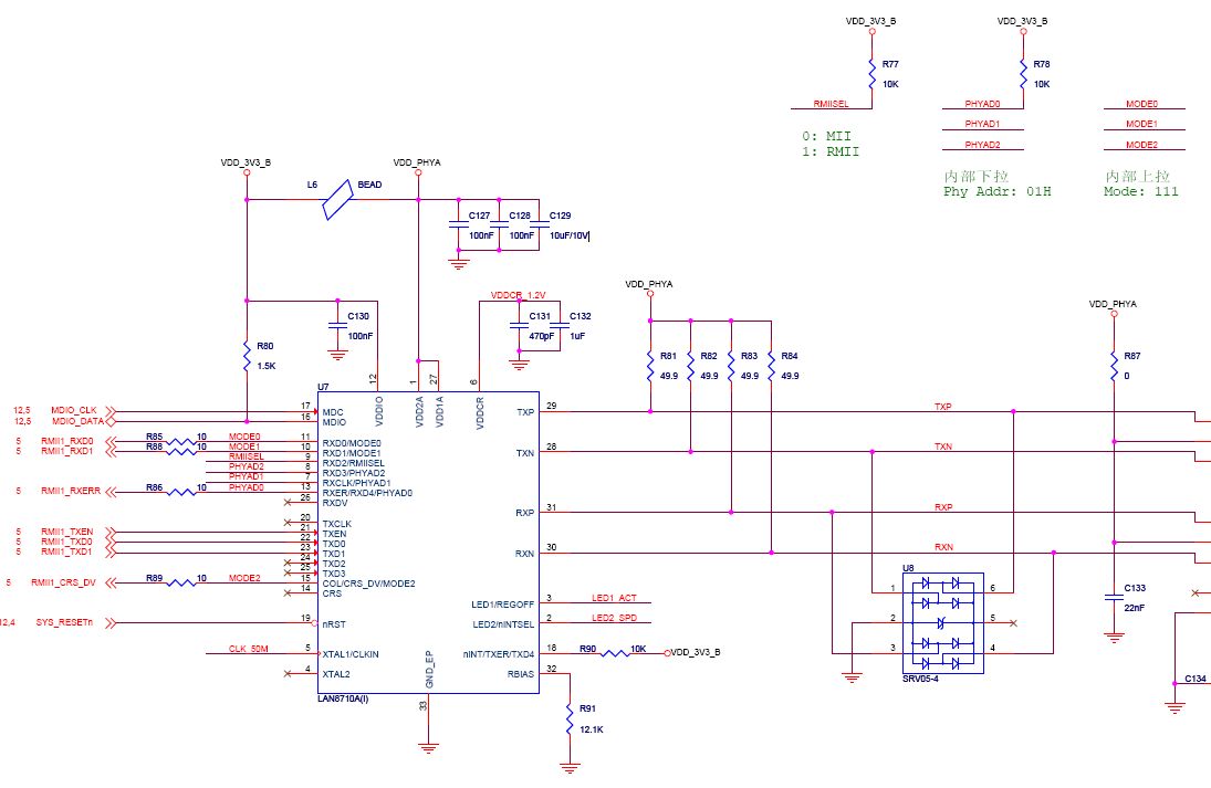

Hi 朋友们,
我遇到这样的问题: AM335x的PHY  AR8031换成LAN8710a, 修改驱动后,现在能够ping通主机,但有丢包现象,系统启动打印如下:
Configuring network interfaces... [   10.135635] jin+ net cpsw_slave_open(), priv->ndev->name=eth0, slave->data->phy_id=0:01
[   10.287035] jin+ net cpsw_slave_open(), priv->ndev->name=eth1, slave->data->phy_id=0:00
[   10.295576] PHY 0:00 not found
udhcpc (v1.20.2) started
Sending discover...
[   13.208297] PHY: 0:01 - Link is Up - 100/Full
然后ping主机打印如下:

root@ok335x:~# ping 192.168.6.244
PING 192.168.6.244 (192.168.6.244): 56 data bytes

48 packets transmitted, 22 packets received, 54% packet loss
round-trip min/avg/max = 0.780/0.854/0.942 ms

电路图如 附件:sch.jpg
我的pinmux 如下:
/* Module pin mux for rmii1 */
static struct pinmux_config rmii1_pin_mux[] = {
 {"mii1_crs.rmii1_crs_dv", OMAP_MUX_MODE1 | AM33XX_PIN_INPUT_PULLDOWN},
 {"mii1_rxerr.mii1_rxerr", OMAP_MUX_MODE1 | AM33XX_PIN_INPUT_PULLDOWN},
 {"mii1_txen.mii1_txen", OMAP_MUX_MODE1 | AM33XX_PIN_OUTPUT},
 {"mii1_txd1.mii1_txd1", OMAP_MUX_MODE1 | AM33XX_PIN_OUTPUT},
 {"mii1_txd0.mii1_txd0", OMAP_MUX_MODE1 | AM33XX_PIN_OUTPUT},
 {"mii1_rxd1.mii1_rxd1", OMAP_MUX_MODE1 | AM33XX_PIN_INPUT_PULLDOWN},
 {"mii1_rxd0.mii1_rxd0", OMAP_MUX_MODE1 | AM33XX_PIN_INPUT_PULLDOWN},
 {"rmii1_refclk.rmii1_refclk", OMAP_MUX_MODE0 | AM33XX_PIN_INPUT_PULLDOWN},
 {"mdio_data.mdio_data", OMAP_MUX_MODE0 | AM33XX_PIN_INPUT_PULLUP},
 {"mdio_clk.mdio_clk", OMAP_MUX_MODE0 | AM33XX_PIN_OUTPUT_PULLUP},
 {NULL, 0},
请朋友们帮我分析一下,丢包会是什么原因?
谢谢了!
