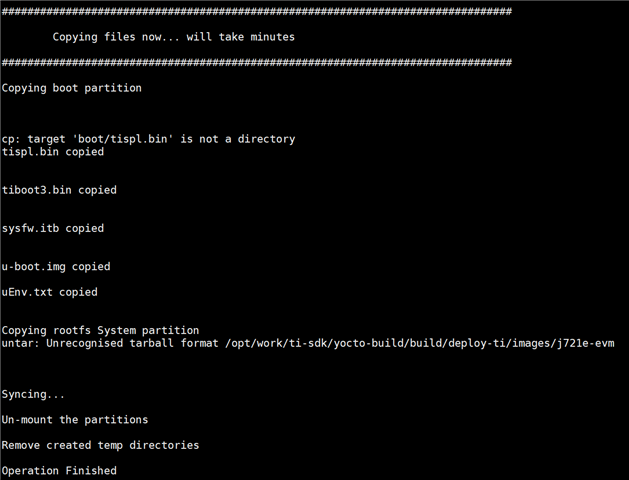

Hello, referring to the guide at this link, I encountered errors while attempting to create the image and flash it to the SD card.
  1. What should be selected for the boot partition and rootfs partition when creating a custom SD card? Should both be from deploy-ti/images/j721e-evm?
  2. Can the kernel image and device tree files simply select "Reuse kernel image and device tree files found in the selected rootfs"?
  3. Will there be any impact if the setup.sh script was not run before building the SDK with Yocto?
  4. Is “installing SDK -> yocto to build SDK, generating deploy ti/images/j721e-evm/ -> running create sdcard.sh” the complete process of burning the image?

  • According to your explanation, the wic.xz file built by Yocto needs to be written to the SD card using bmaptool. However, the only wic.xz file in the deploy-ti/image/j721e-evm directory generated by Yocto-build is the following rootfs.wic.xz. Writing only rootfs.wic.xz should not be correct, right?
    ubuntu22@ubuntu22:/opt/work/ti-sdk/yocto-build/build/deploy-ti/images$ find ./ -name "*wic*"
    ./j721e-evm/tisdk-base-image-j721e-evm.rootfs.wic.bmap
    ./j721e-evm/tisdk-base-image-j721e-evm.rootfs-20250410071832.wic.bmap
    ./j721e-evm/tisdk-base-image-j721e-evm.rootfs.wic.xz
    ./j721e-evm/tisdk-base-image-j721e-evm.rootfs-20250410071832.wic.xz
    As I intended to experiment with the P2P configuration and only modified the .CONFIG file, would it be sufficient to flash only the rootfs? If not, what additional steps are required, and how should I proceed?
    Also, how should the uboot and dtb files be written?

  • Alright, I’ll try my best. But I still want to ask about the standardized procedure for building a custom image. The j721e instruments(1.1.4. Create SD Card — Processor SDK Linux for J721e Documentation) process feels disordered and unclear in each step.
    For example, after I modify the .config file (or possibly the device tree or kernel source) and recompile the kernel, I encounter issues where create_sdcard.sh cannot find MLO and u-boot.img.
    Could you please provide a standardized and complete workflow?

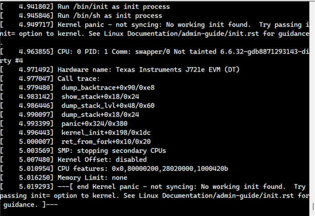

  • Thank you for your reply. I followed the example from "1.1.7. Simplified SDK Build Using Top-Level Makefile — Processor SDK Linux for J721e Documentation" exactly to create the SD card.
    I tried to build the SD card using the top-level Makefile, but after running make u-boot_install and make linux_install, I found that the rootfs-partition only contains the bin and lib directories. After booting the development board, a kernel crash occurred due to the absence of a valid init program. What could be the cause of this issue? Could it be that the setup.sh script did not run completely?
    What could be the reason for this? Could it be because the setup.sh script did not run completely earlier?

  • Sorry, the development board did not boot correctly. It’s possible that you didn’t see my latest reply because I had edited it. Here is my previous message:
  • 您好,
     SDK Makefile 还允许用户自定义源和镜像,但需要生成可启动到 SD 卡。它将在预先存在的映像上安装编辑。
    请问您是否已有可启动的SD卡?
