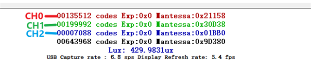

Hello experts,
I’m trying to run OPT4060DT_SEVM GUI version 1.0.1 with OPT4001DNPQ1EVM.

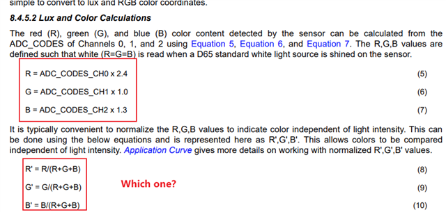

1、Which of ADC_CODES , RGB ,R'G'B',is the value of OPT4060DTSEVM GUI?

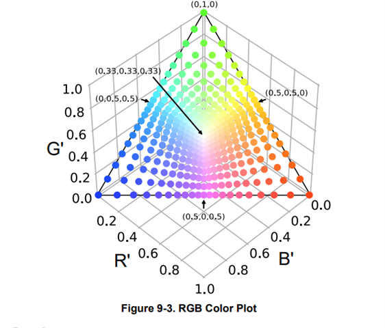

2、Do you have a specific range of R'G'B' for the color? I noticed that only Figure 9-3. RGB Color Plot is relevant in OPT4060 datasheet.
