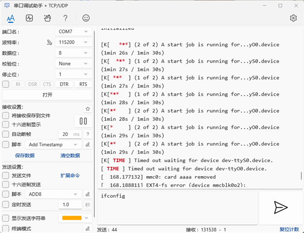

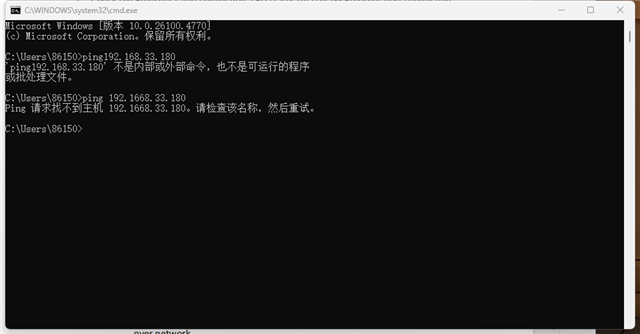

When using the cascaded radar and MMWCAS-DSP-EVM to connect to mmwave studio3.0, the TDAX board cannot be connected, and an error is reported as shown in the picture. The wiring connection is normal, the computer's network port configuration is correct, and the indicator light on the acquisition board is on. The firewall has been turned off. The connection still fails even after replacing different PCs and network cables. The connection via WinSCP times out, and the connection via serial port also times out, as shown in the picture. How to solve this problem? Could it be an issue with the operating system?
