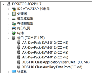

主要参考DCA1000EVM Quick Start Guide,使用DCA1000EVM和IWR6843ISK进行数据采集,无法配置成功。描述如下:
1、硬件连接方式
2、PC配置

3、dca1000 +iwr6843isk上电后,和pc建立连接
4、open mmwave studio

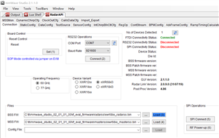

5、Connect operation,RS232' connect一直失败,无法进行下一步
[14:55:00] [RadarAPI]: Opening Gpio Control Port()
[14:55:00] [RadarAPI]: Status: Passed
[14:55:01] [RadarAPI]: Opening Board Control Port()
[14:55:01] [RadarAPI]: Status: Passed
[14:55:02] [RadarAPI]: ar1.FullReset()
[14:55:02] [RadarAPI]: Status: Passed
[14:55:02] [RadarAPI]: Closing Board Control Port()
[14:55:02] [RadarAPI]: Closing Gpio Control Port()
[14:55:02] [RadarAPI]: ar1.SOPControl(2)
[14:55:03] [RadarAPI]: ar1.frequencyBandSelection("60G")
[14:55:04] [RadarAPI]: ar1.SelectChipVersion("IWR6843")
[14:55:04] [RadarAPI]: Status: Passed
[14:55:04] [RadarAPI]: ar1.deviceVariantSelection("IWR6843")
[14:55:06] [RadarAPI]: ar1.Connect(7,115200,1000)
[14:55:06] [RadarAPI]: Error: Serial Port Init(): 连到系统上的设备没有发挥作用。
[14:55:06] [RadarAPI]: Error: Connection failed: Calling_ConnectTarget returned 1
[14:55:06] [RadarAPI]: ar1.Calling_IsConnected()
[14:55:06] [RadarAPI]: ar1.SaveSettings('C:\Users\chenzj\AppData\Roaming\RSTD\ar1gui.ini')
问题:
1、如果RS232 connect无法 建立连接,尝试了其他几个串口也失败
2、下载BSS MSS也失败
请问改如何配置?还是操作顺序不对?IWR6843ISK SOP配置对吗?谢谢

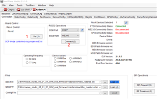

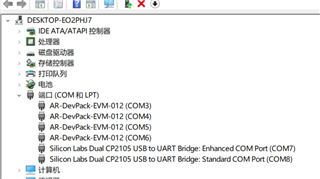

  • 今天更了下设备驱动,尝试了如下操作:
    step1: wait FDTI connectivity status: Connected,  step2、Reset Control, step3:RS232. Opreations,select COM7(Silicon Labs Dual CP2105 USB to UART Bridge: Enhanced COM Port), baudrate:115200, 点击按钮Connect
    结果,连接失败,看log如下:
    [22:43:32] [RadarAPI]: Status: Passed
    [22:43:32] [RadarAPI]: ar1.LoadSettings('C:\Users\chenzj\AppData\Roaming\RSTD\ar1gui.ini')
    [22:43:33] TESTING = false
    [22:43:33] RstdNet: Port 2777: Listening..
    [22:43:33]
    [22:43:33] ***Script completed successfully.***
    [22:43:40] [RadarAPI]: Opening Gpio Control Port()
    [22:43:40] [RadarAPI]: Status: Passed
    [22:43:40] [RadarAPI]: Opening Board Control Port()
    [22:43:41] [RadarAPI]: ar1.FullReset()
    [22:43:41] [RadarAPI]: Status: Passed
    [22:43:42] [RadarAPI]: Closing Board Control Port()
    [22:43:42] [RadarAPI]: Status: Passed
    [22:43:42] [RadarAPI]: Closing Gpio Control Port()
    [22:43:42] [RadarAPI]: ar1.SOPControl(2)
    [22:44:02] [RadarAPI]: ar1.Connect(7,115200,1000)
    [22:44:04] [RadarAPI]: Error: Connection failed: Calling_ConnectTarget returned 3
    [22:44:04] [RadarAPI]: ar1.Calling_IsConnected()
    [22:44:04] [RadarAPI]: ar1.SaveSettings('C:\Users\chenzj\AppData\Roaming\RSTD\ar1gui.ini')
    [22:45:04] [RadarAPI]: Opening Gpio Control Port()
    [22:45:04] [RadarAPI]: Status: Passed
    [22:45:04] [RadarAPI]: Opening Board Control Port()
    [22:45:05] [RadarAPI]: ar1.FullReset()
    [22:45:05] [RadarAPI]: Status: Passed
    [22:45:06] [RadarAPI]: Closing Board Control Port()
    [22:45:06] [RadarAPI]: Status: Passed
    [22:45:06] [RadarAPI]: Closing Gpio Control Port()
    [22:45:06] [RadarAPI]: ar1.SOPControl(2)
    [22:45:08] [RadarAPI]: ar1.Connect(7,115200,1000)
    [22:45:10] [RadarAPI]: Error: Connection failed: Calling_ConnectTarget returned 3
    [22:45:10] [RadarAPI]: ar1.Calling_IsConnected()
    [22:45:10] [RadarAPI]: ar1.SaveSettings('C:\Users\chenzj\AppData\Roaming\RSTD\ar1gui.ini')
  • SW1配置有问题,请参考3.9 DCA1000EVM Mode的Table 3-4. S1 Config for DCA1000EVM mode
    https://www.ti.com/lit/ug/swru546d/swru546d.pdf
  • 谢谢你的快速回复,连接的问题解决了,谢谢!

    [11:34:00] [RadarAPI]: ar1.frequencyBandSelection("60G")
    [11:34:00] [RadarAPI]: ar1.ReadRegister(0xffffe218, 0, 31)
    [11:34:00] [RadarAPI]: ar1.DownloadBSSFw("C:\\ti\\mmwave_studio_02_01_01_00\\mmWaveStudio\\Scripts\\..\\..\\rf_eval_firmware\\radarss\\xwr68xx_radarss.bin")
    [11:34:04] [RadarAPI]: Downloading BSS ROM RPRC Binary..
    [11:34:52] [RadarAPI]: ar1.GetBSSFwVersion()
    [11:34:52] [RadarAPI]: BSSFwVersion:(00.00.00.00 (00/00/00))
    [11:34:52] [RadarAPI]: Warning: BSS firmware version Mismatch!
    [11:34:52] BSS FW Download Success
    [11:34:52] [RadarAPI]: ar1.DownloadMSSFw("C:\\ti\\mmwave_studio_02_01_01_00\\mmWaveStudio\\Scripts\\..\\..\\rf_eval_firmware\\masterss\\xwr68xx_masterss.bin")
    [11:42:46] MSS FW Download failure
