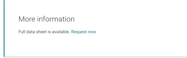

Hello,PGA900 is one NDA product, did you have requested the full datasheet from the TI website?
OK, I need to confirm this question again, and I would reply you as soon as possible.
No problem, and I would reply to you once I have confirmed about this problem.
