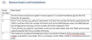

已经配置好了参数脚本,代码如下:
Sequence being followed
A. CONFIGURATION

-- Frame configuration
local start_chirp_tx            =   0
local end_chirp_tx              =   3
local nchirp_loops              =   64     -- Number of chirps per frame
local nframes_master            =   10     -- Number of Frames for Master
local Inter_Frame_Interval      =   100    -- ms
local trigger_delay             =   0      -- us
local trig_list                 =   {1,2,2,2} -- 1: Software trigger, 2: Hardware trigger

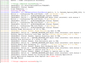

------------------------------ API Configuration ------------------------------------------------
-- 1. Connection to TDA. 2. Selecting Cascade/Single Chip.  3. Selecting 2-chip/4-chip
WriteToLog("Setting up Studio for Cascade started..\n", "blue")
if(0 == ar1.ConnectTDA(TDA_IPAddress, 5001, deviceMapOverall)) then
    WriteToLog("ConnectTDA Successful\n", "green")
else
    WriteToLog("ConnectTDA Failed\n", "red")
    return -1
end
if(0 == ar1.selectCascadeMode(1)) then
    WriteToLog("selectCascadeMode Successful\n", "green")
else
    WriteToLog("selectCascadeMode Failed\n", "red")
    return -1
end
WriteToLog("Setting up Studio for Cascade ended..\n", "blue")
