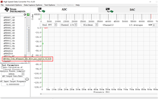

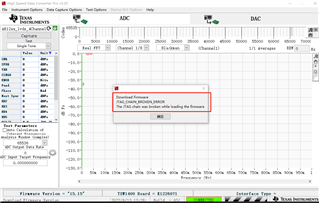

这个上面没有所说的那个,只有这个

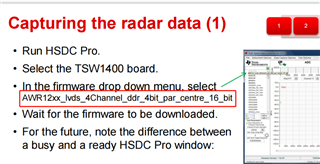

这个文件在\mmwave_studio_02_01_00_00\mmWaveStudio\HSDCProFiles目录下。请看一下mmwave studio user guide说明。
Copy AWR12xx_lvds_4Channel_ddr_4bit_par_centre_xx_bit.ini files from mmwave_studio_\ mmWaveStudio\HSDCProFiles to ‘1400 details\ADC files\’ folder in the HSDCPro installation
https://software-dl.ti.com/ra-processors/esd/MMWAVE-STUDIO/latest/exports/mmwave_studio_user_guide.pdf
