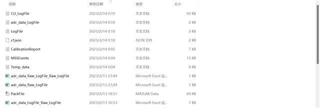

我按照DCA1000EVM使用指南 - 嵌入式处理 - 技术文章 - E2ETm 设计支持 (ti.com)上的步骤使用mmwave_studio_02_01_01_00进行数据采集
文中“9)在数据获取结束之后,LED灯DATA_TRAN_RPG绿光闪烁一次,并保持常绿。表明数据获取成功。点击PostProc,出现如下结果:“此时我的DATA_TRAN_RPG绿光闪烁几秒之后保持常绿,但是点击PostProc时报错:【Error : The number of files captured is zero!】
下图是我的硬件连接
下面是我采集过程中的相关信息

[00:05:57]  [RadarAPI]: ar1.CaptureCardConfig_StartRecord("C:\\Apps\\mmwave\\studio\\mmwave_studio_02_01_01_00\\mmWaveStudio\\PostProc\\adc_data.bin", 1)
[00:05:57]  [RadarAPI]: Sending start_record command to DCA1000
[00:06:01]  [RadarAPI]: ar1.StartFrame()
[00:06:01]  [RadarAPI]: Status: Passed
[00:06:01]  Frame start async event received!
[00:06:07]  [RadarAPI]:
[00:06:07]  Start Record :
[00:06:07]  Timeout Error! System disconnected
[00:06:09]  Frame End async event received!
[00:06:09]  [RadarAPI]: Frame Ended
[00:06:15]  [RadarAPI]: ar1.StartMatlabPostProc("C:\\Apps\\mmwave\\studio\\mmwave_studio_02_01_01_00\\mmWaveStudio\\PostProc\\adc_data.bin")
[00:06:15]  [RadarAPI]: No of files Captured: 0, Total no of frames for each device : 200
[00:06:15]  Error : The number of files captured is zero!
以下是我的获得的文件
恳请指正,期待您的答复!
